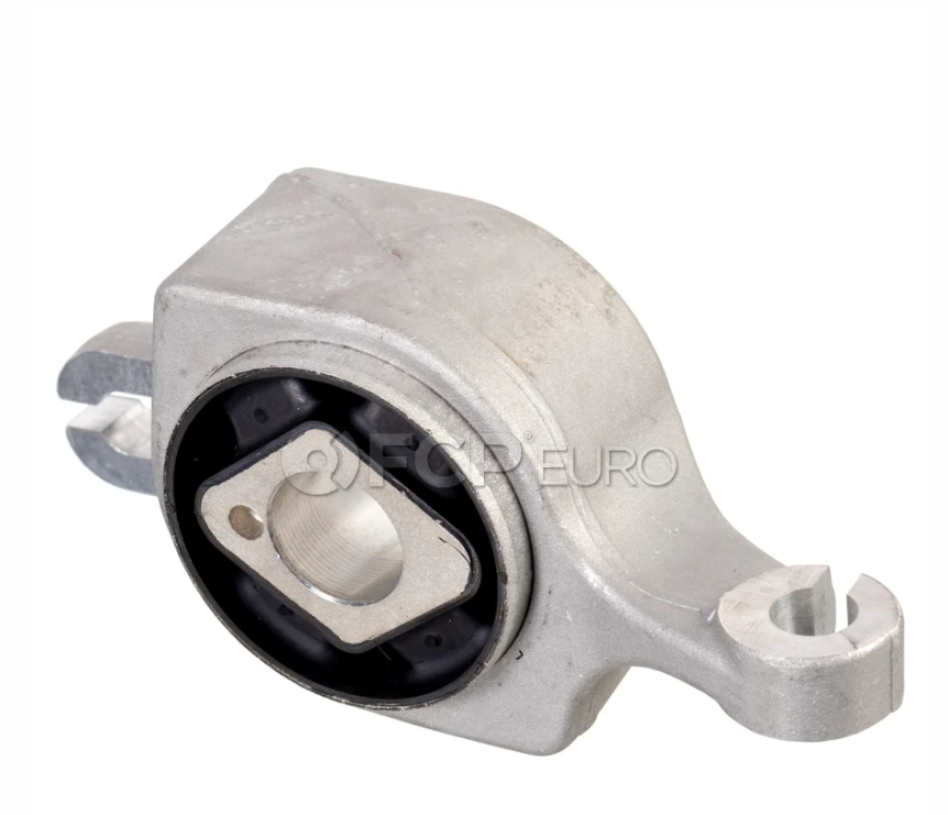

So I saw a video of someone replacing a rear bushing on an R-class (W251) and it bolted to the control arm, ours look similar but look like they are maybe pressed onto the control arm. Just wondering if anyone has replaced just the Rear bushing on the Lower control arms? my front bushing doesn't look bad, no cracks or anything, so I was hoping just to do the rears, but if I have to remove the Control arm and press it, Maybe I should just replace the whole control arm, I know it is more expensive, but I don't currently have a press so I would either have to take it to a shop or go buy a tabletop press.

From memory I believe the procedure is to replace the arm+bushing as an assembly. Someone should have WIS and post it..

bushing install tool and press you can get for 140$,its worth it and you will use it for many years,easy way to get the bushing out iif its seized s by cutting it with a saw just make sure not cut past the body of the bushing,aluminum is pretty soft

For reference this is the bushing I am referring too. So it does seem these are pressed on. I will probably return them when they arrive and just purchase the complete control arms.

For me - it was just easier to get the entire assemblies from FCP and move on. I know they were done correctly.
