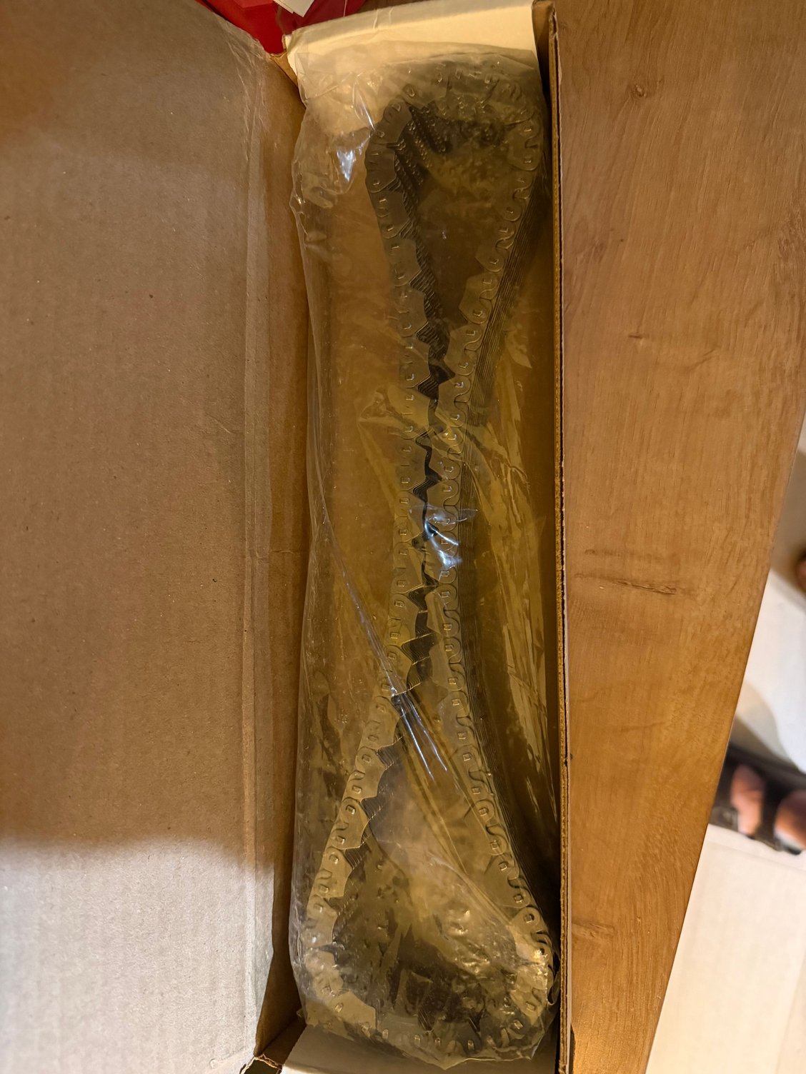

not happy with how it shifts so i am going to replace it,this is basically the same chain like on a W164,this doesnt fit cars with offroad package although i read some say it fits,it will be interesting to see how streched it is,you will need around half a liter of MB 236.14 fluid
