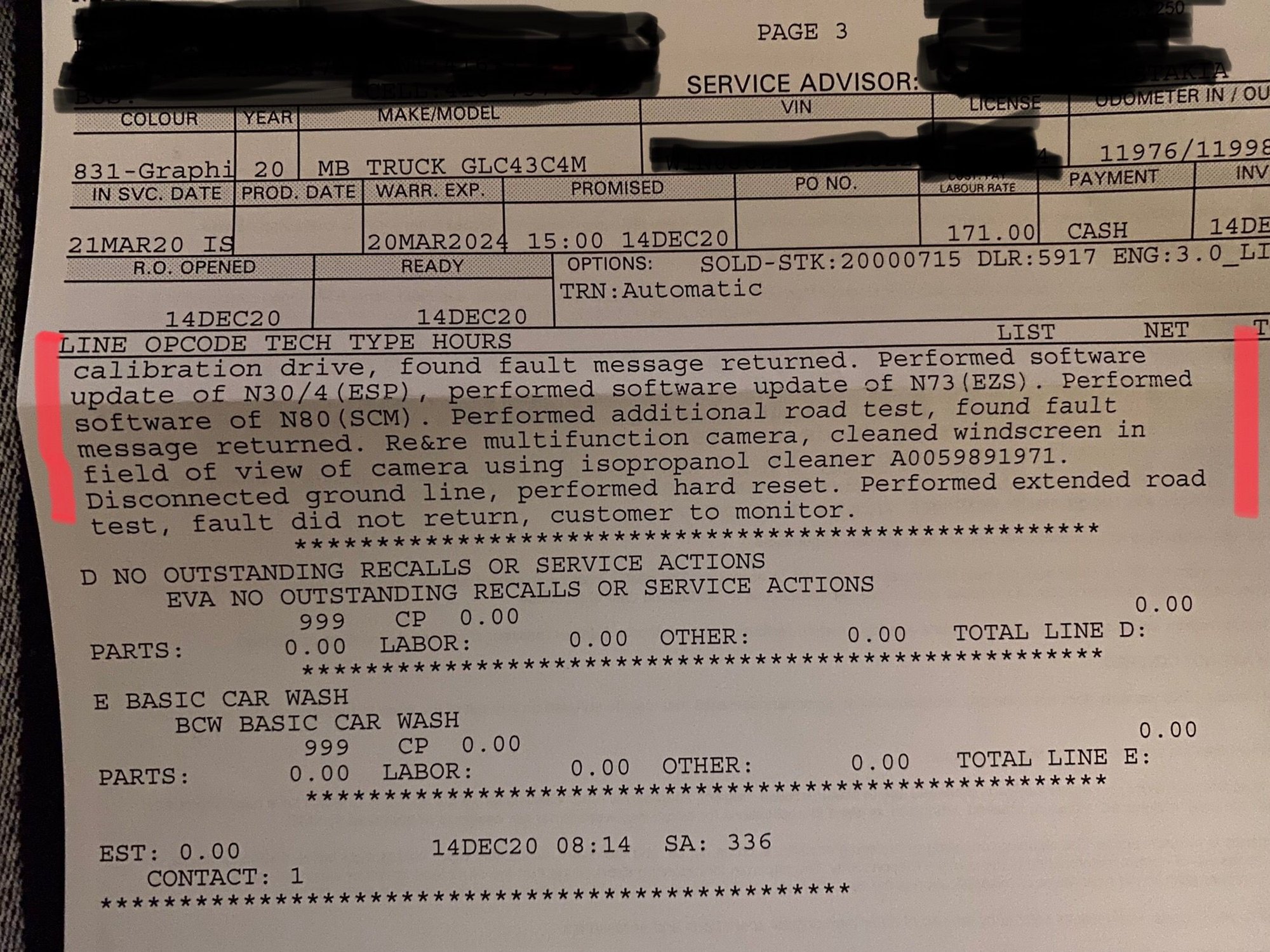

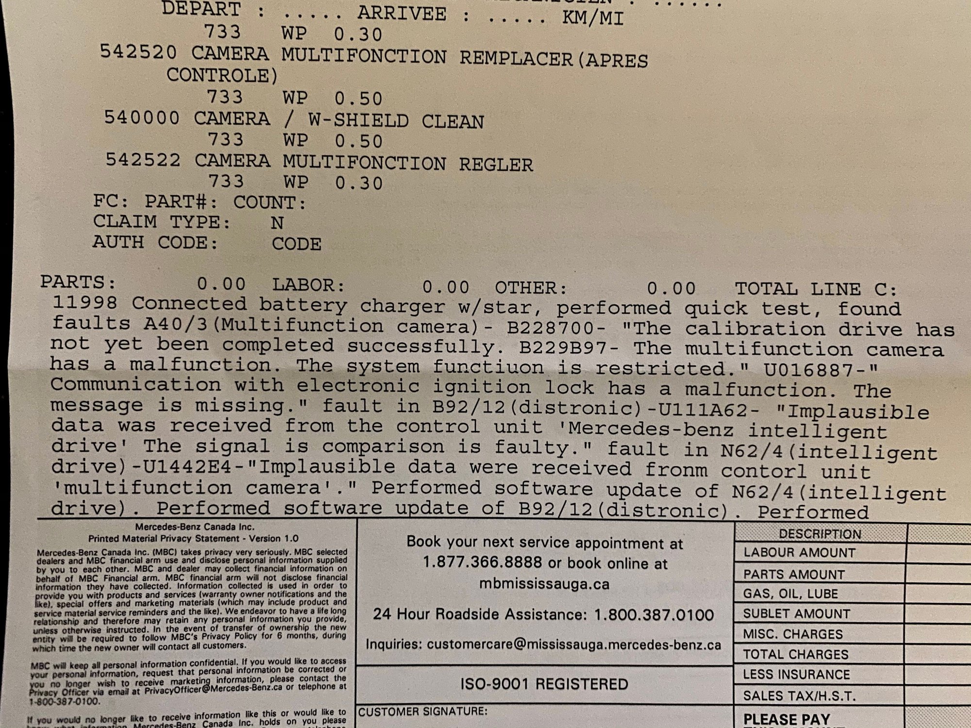

Hi -
I purchased a 2020 GLC 43 coupe with the driver assist package. One of the reasons I purchased Mercedes over other brands was based on research, and MB marketing promoting these features. Active brake assist was the most important from my perspective. And, indeed, it help me a avoid a potentially serious accident on the highway several months ago.
Unfortunately, active brake assist has been the most flaky. I have taken it in 3 times to Mercedes for software updates and other diagnostics to address the issue. Since acquiring the car in March, warning messages that active brake assist is either unavailable or limited constantly pop-up to the point of annoyance. Sometimes it say to consult the owners manual, other times to pull over. Bottom line is that it becomes uncertain whether the message is legitimate due to weather conditions or a dirty camera lens, or the system isn’t functioning at all. My last visit to MB was this week. I’m hopeful they’ve fixed it on the 3rd try but not convinced. Please see diagnosis data from the last visit:

So basically, your windshield was dirty.

I don’t think so. The messages came up when the car was clean, driving in clear, cloudy, snow or sunny,conditions. There was no pattern.
i will say that if the the final repair doesn’t take, I will be listing the car for sale. The car has been excellent otherwise.
