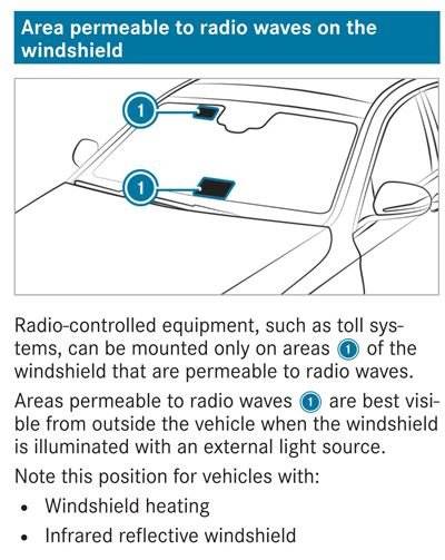

There are two defined areas where the windshield coating does not impact reception.

I tested it out and it's a significant reduction. I tested with a Stalker II MDR and the range went from 2200ft when place behind the reception area GregW mentioned down to 500ft when placed behind the non reception area.
Yeah but neither of those are idea.
For the one next to the mirror, it's too far to the right to see the display and mute it. Plus I want to place a dash cam there so that GPS activated parking mode is actuated properly.
For the lower one, it gets way too hot in the summer, very difficult to reach, not easy to hard wire install, theft risk, lower performance, and that's where I will most likely place my EZ Pass since I cant place it higher up...
Wish they still offered the window to the left of the mirror like they used to...
You rock, thanks for sharing this. I put my radars to the right of the overhead console.

My next concern is that if I do end up getting pulled over, last thing I want is for the cop to see my reaching over to take the RD down. But that's awesome that you can reach that far. I can't even see the screen on my detector when it's mounted there and it's important for me as I use the frequency info to determine if it's a legitimate threat or not.
Stalker radar is what they use most commonly around here so I tested with that. But I have almost every handheld and installed radar units used in the US as well as all the LIDAR guns. Consequence of being one of the owners of RDForum lol
I think I am going to install Radenso RC-M in the grill, but Radenso is releasing Theia eventually which will be windshield mount. So I still got to figure out what to do.
As for the EZ Pass license plate mount, I live in NYC and I learned that those things are easily damaged by people bump parking. Plus some places try to ticket you for obstructing part of the license plate...
