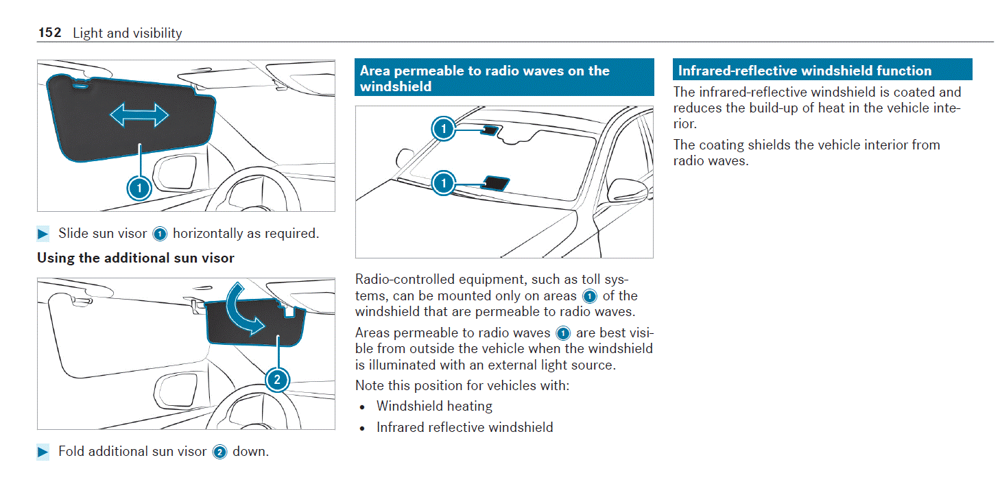

Car manual lists two locations where you can put your toll tag or stickers.

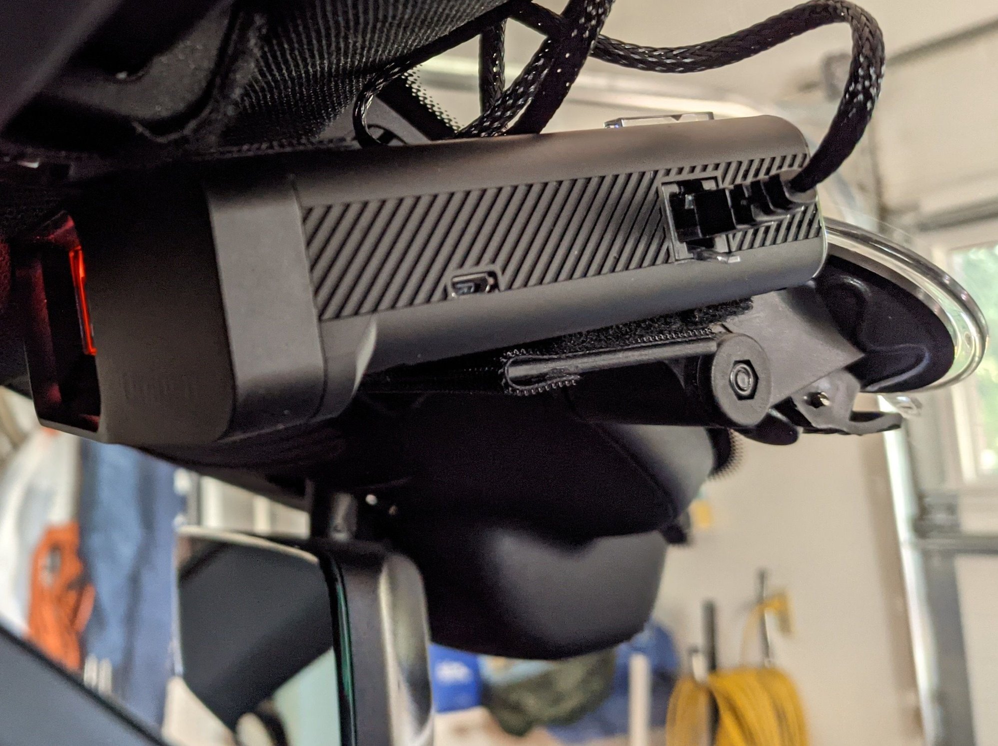

The acoustic glass keeps your radar detector from operating properly as well unless you mount it on your windscreen in the proper location. You also won't get signals from the rear (such as an oncoming law enforcement officer
Old Feb 11, 2020 | 12:07 AM
btshep's Avatar
Joined: Oct 2006
Posts: 184
Likes: 32
From: North Jersey
2020 GLE 580 | 2020 Ram 1500 Limited
The best radars are the ones with remote sensor units. In my soon to be retired '07 W164 I have the K40 Calibre mounted behind the front grille and tin found behind the plastic behind the back bumper cover. The 2 led indicators are mount inside the front climate vents. its a very clean install that is invisible even though systems are allowed in NJ, I even went so far as to mount an exterior EzPass tag (they look horrible attached to the front plate) behind the front grille. For the longest time there my windshield was super clean with nothing mounted to it until I added a BlackVue about 1.5 years ago

a
If you look closely at the glass there are tiny red squares marking the 2 locations. I don't know if all the windshields have these markings or just the acoustic package.

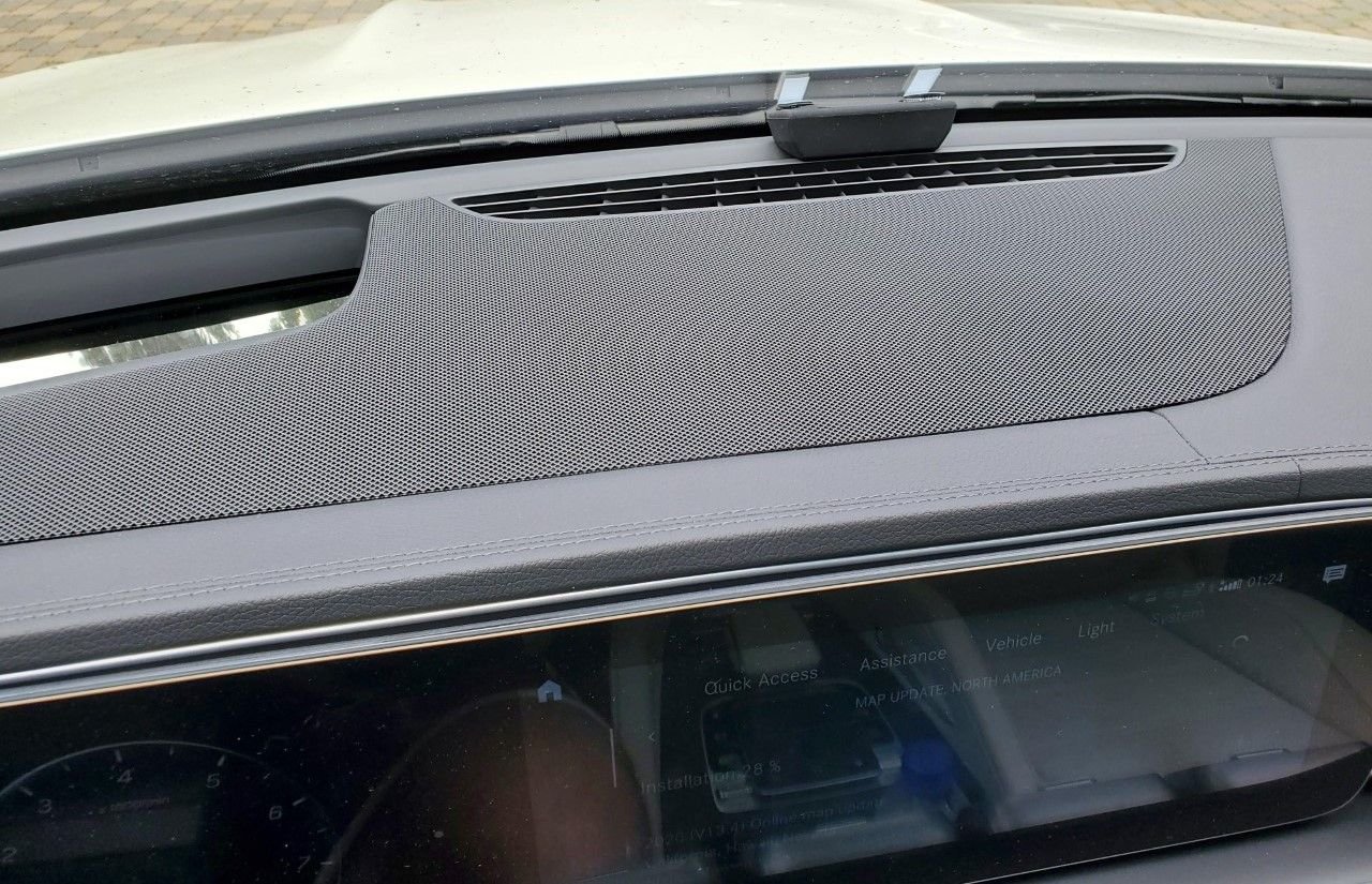

I have the acoustic package and put my EZ Pass transponder in the lower center area of the windshield. I also got this black silicon sleeve from
Amazon Amazon
so that it wouldn't stick out like a sore thumb.
I never bothered to actually stick it to the windshield, it seems to fit snugly just resting there. That's why you see 2 white strips reflecting off the window, I still have the removable plastic that reveals the adhesive. I don't notice them while driving, I guess the camera makes them look more prominent.
