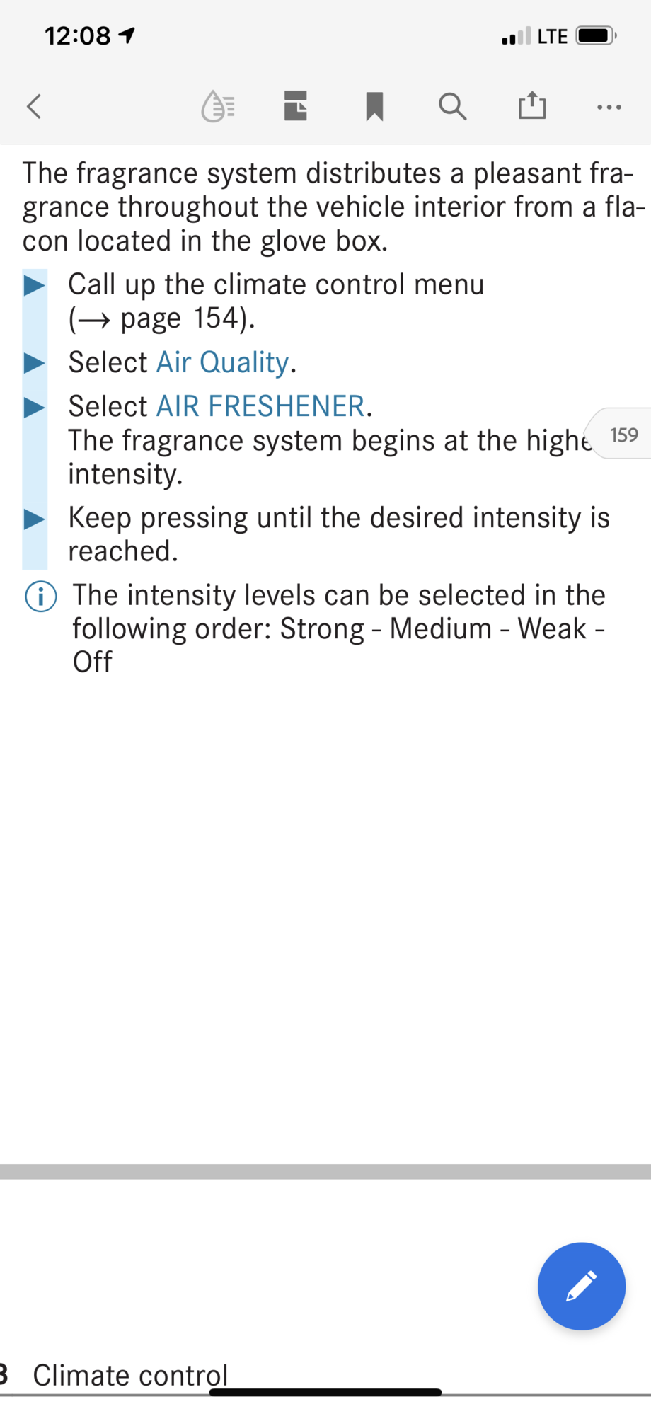

The fragrance intensity is fully adjustable using MBUX. Is it possible it’s set to “off” in the vehicle you are concerned about. See pic in manual with instructions on checking/adjusting the fragrance intensity.
