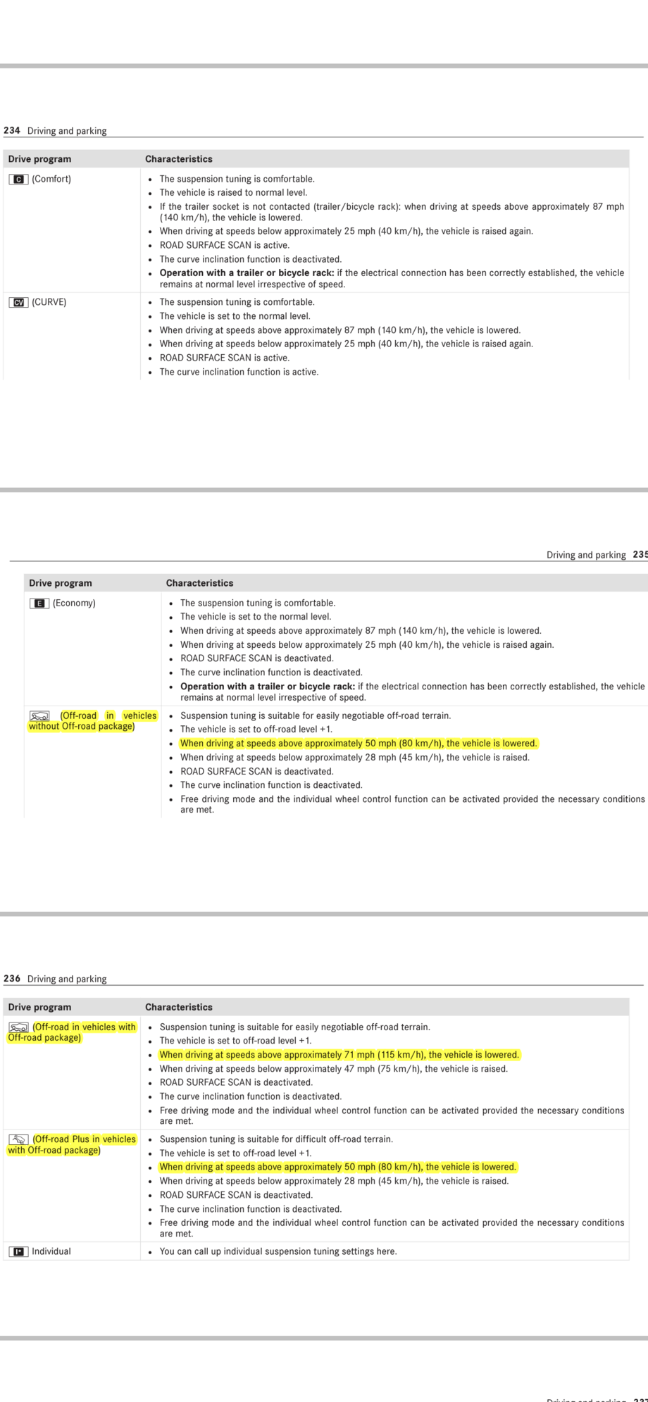

Yes, according to the owners manual the GLS (2020+) will automatically lower above 80km/h (50mph) or 115km/h (71mph) but it seems to only occur when in “off rode” driving program.

In Off Road mode etc. it lowers from a +1 level to Normal or 0 level. What I am describing is going from Normal level or 0 to -1.

Aug 4, 2020 | 07:08 AM
I noticed that in Comfort, it starts at 0, then lowers to -1 at 80mph.
Curve mode starts at -1.
Sport+ starts at -2.
Offroad starts at +1.

Aug 4, 2020 | 02:23 PM
It says right there in those first 2 pages of the manual that Comfort, Curve, and Economy all start at Normal and lower above 140 km/h. That means it goes from Normal to -1.
As for your next question of whether this can be changed that's something you would have to ask the custom programmers.
