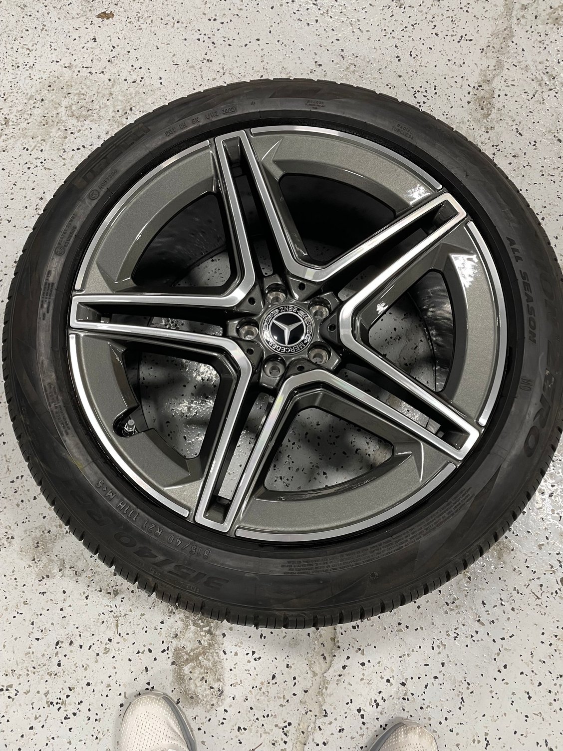

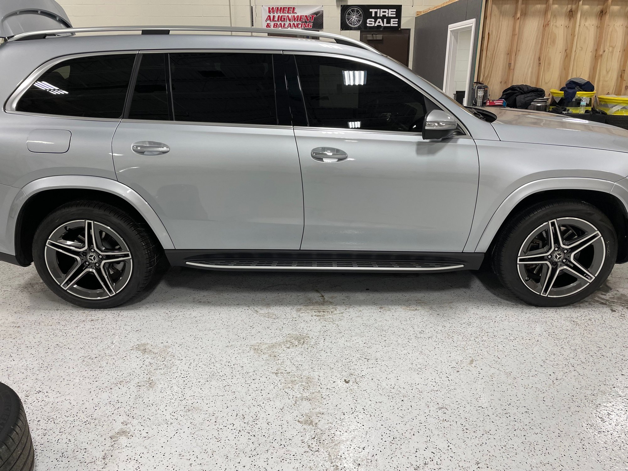

I posted this in another thread but I figured I would add it here as well. I went with 21" replica AMG 5 Spokes with the Pirelli MO all seasons. I got 6 total so I had two spares. I live in Michigan and these will be more than sufficient for anything I get into. I'm into everything for less than $2000 total which I'm also happy about.
