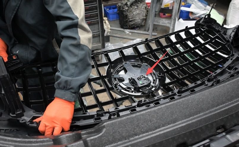

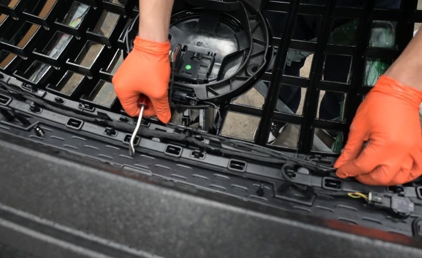

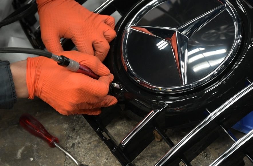

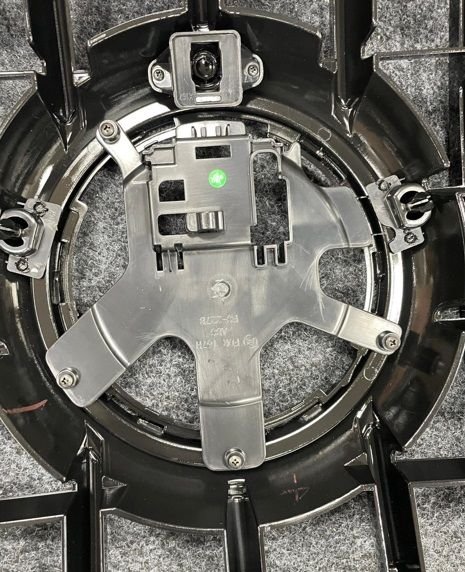

Originally Posted by rdornala
mine is 2026 GLS 450 with Pinnacle Trim , i see that lots of sensors related to distonic are located in the circle can it be done ??
here are you more photos for refference if you need.
the grille have camepra holder and sensor holder
the grille have camera holder and sensor holder
there is a dummy cover on the camera hole for the version without 360 system. so just remove the cover and polish the edge.
the camera can be fit on well
the sensor can be install on the holder
move those cables and parking etc to new grille
move those original cables and parking sensor etc to new grille. better to prepare some sensor extension cables incase
