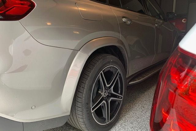

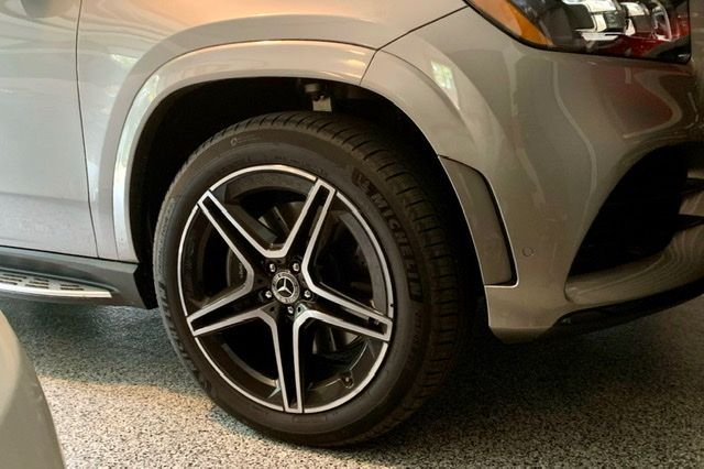

2011 Audi A4, 2014 E63S Wagon, 2020 GLS 580
@carlosamg50 Here are pix of my 580 with 21” wheels in normal/comfort and sport+ height. Hope this helps. It isn’t dramatic but you can easily see the different especially up front with the exposed strut inside the wheel well.

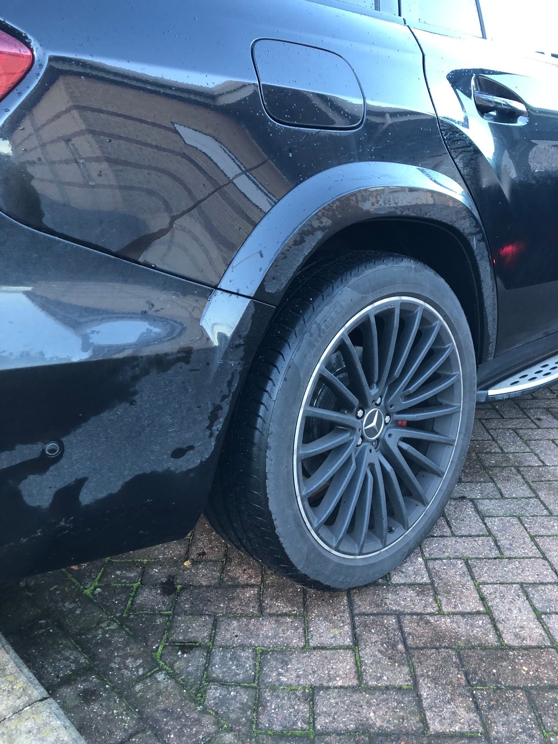

AMG GLS63
Here’s my X166 GLS63 on 22’s in S+, looks like the X167 rides lower then?
Old Nov 2, 2020 | 07:42 AM
ksalno's Avatar
Joined: Dec 2009
Posts: 287
Likes: 55
From: McLean, VA
It appears so!

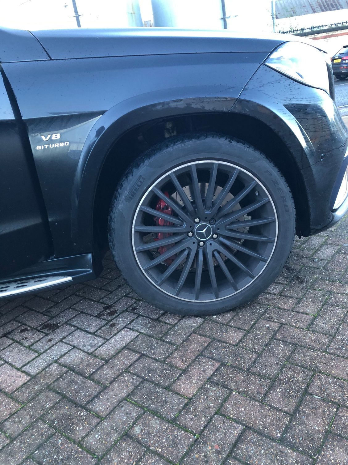

Old Jul 18, 2023 | 10:21 AM
