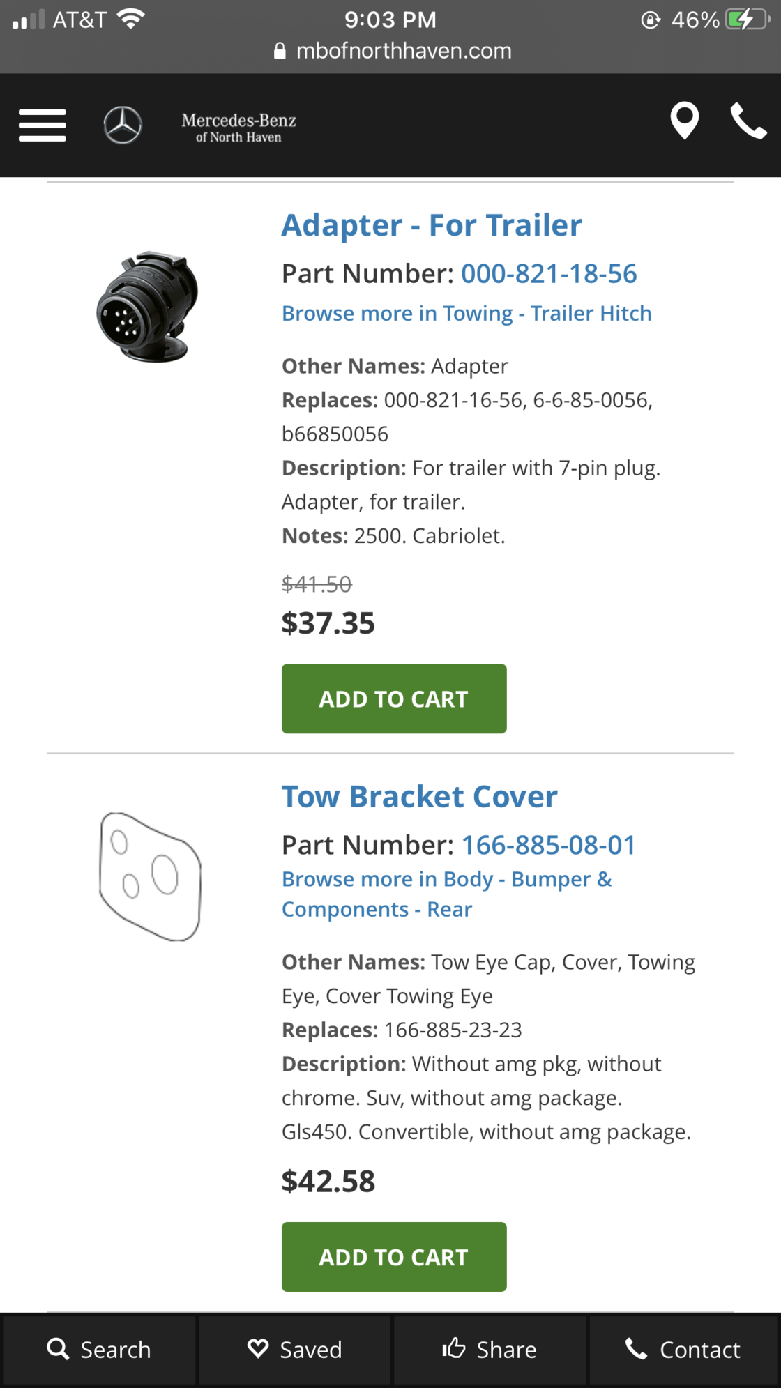

E: MB offers the parts on their website but claim that “they” don’t offer towing package unless it’s ordered that way...
So update:
2019 MB Gls 450 is advertised to tow
Has towing instructions in the manual
Has part numbers for the tow package parts
But can NOT be retrofitted to tow if it did not get preassembled at the factory....

I think you have posted all or most of the parts needed to do a factory retrofit, except the chassis reinforcement. I'd hate to order those parts and find that a key part was missing or unobtainable. As you see, the rear crossmember is needed.
I don't know if the internal chassis reinforcement is part of the V/X167. I have not been able to find a blow-up of the new GLS to see the hitch mounting and parts, so I am making a somewhat educated guess with this reply.
I was surprised to find that M-B didn't offer a hitch package through parts, but since there are so many parts, I think I understand. Plus I found out that not all Dealers were knowledgeable about installation and flashing of the SAM on the previous models.

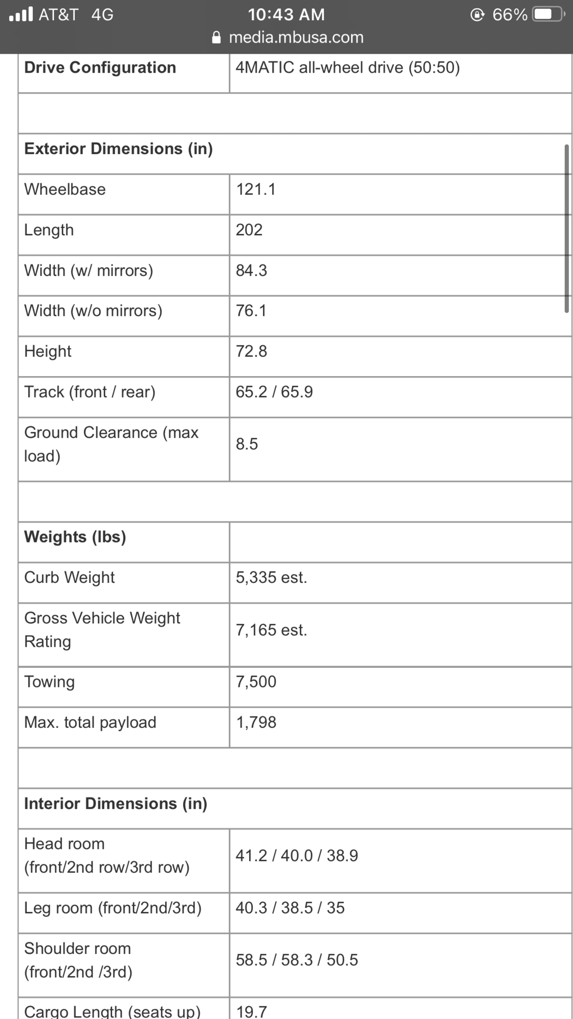

Regarding max trailer, your Payload will be the limiting factor in how much you can tow. While the clip you showed says "max total payload 1765 est," every option that's added decreases your payload by that amount. Look at the sticker on the Driver's Door Post and you will likely see a number between 1,100 and 1,350 as a payload. Payload is everything over a 150# driver and a tank of gas.
The reason payload is the limiting factor, is that you want 10 to 15% (my target is 12%) of the total trailer weight on the tongue, to resist sway. Less than 10% and you WILL likely have sway.
So if you tow the max specified weight, 7500#, you will need at least 750# on the tongue and you have no payload left over for a copilot, dog or lunch. Plus I think the hitch is rated (label on it, too) at @650#.
So you have to work backwards from the payload. Figure how much weight (passengers etc.) you expect to carry, then subtract that from the payload, to figure how much tongue weight you can carry. THEN divide that by .10 to see how heavy your LOADED trailer can be. (DO NOT go by advertised "Dry Weight." As with the M-B (or any tow vehicle) payload, every option on the trailer will add to the Dry Weight. In my experience, most people end up at the trailer's GROSS WEIGHT - if not over - after putting in bedding, dishes, a tank of water and groceries.) In my case, my Lance dry weight was 4414# but, loaded for a week on the road it was RIGHT AT the trailer GVW of 6,000#. Just figure the Gross weight of your trailer.
