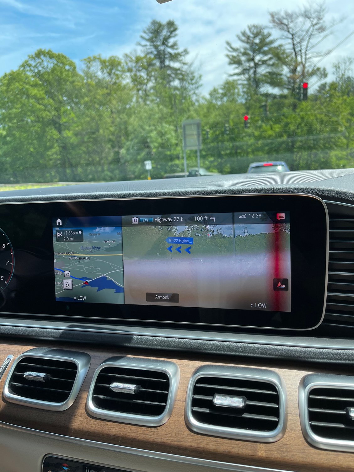

Blurry Augmented Reality Navigation

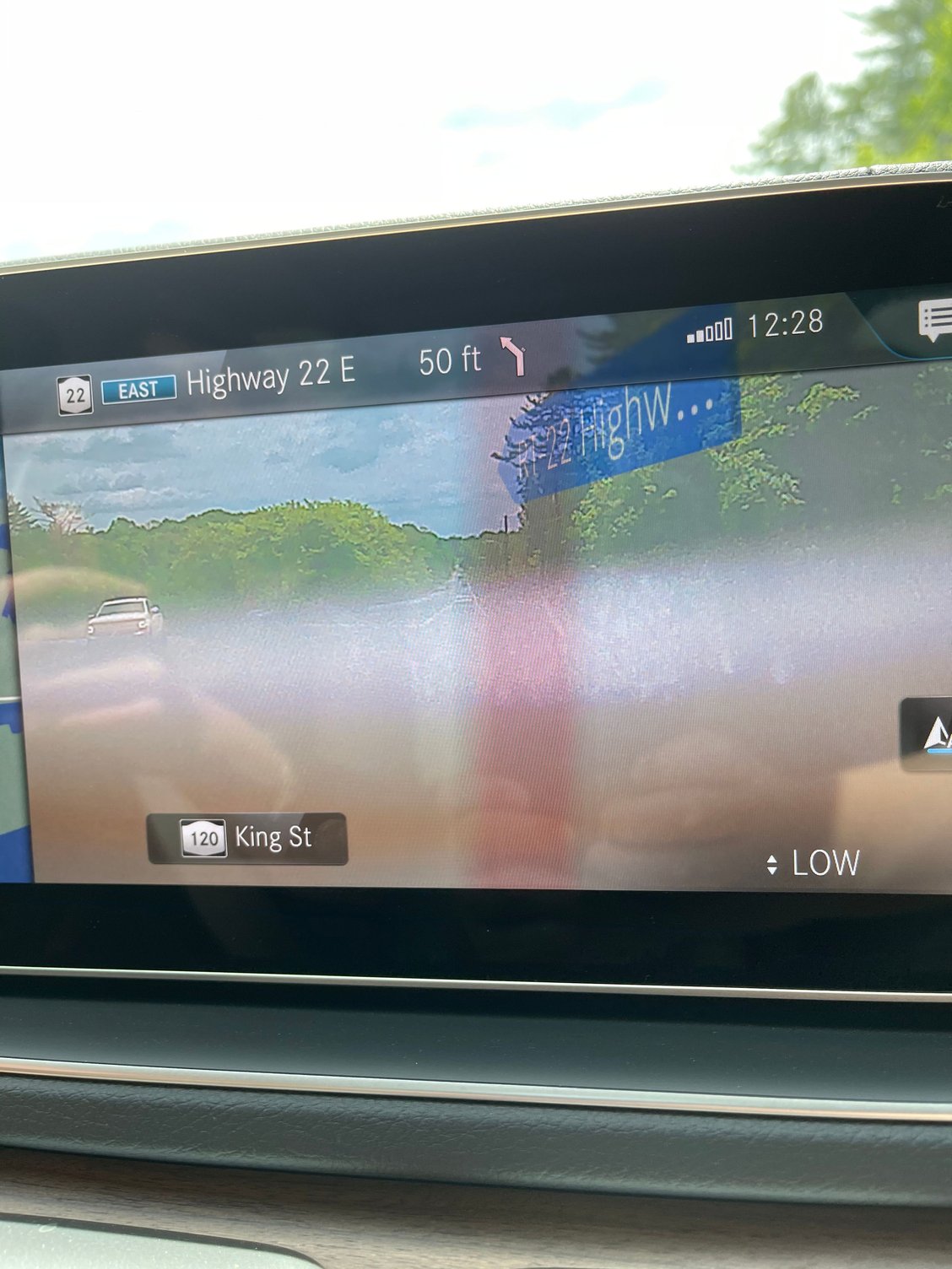

Half of my screen has become blurry. I don’t think the cameras are dirty because I had the car washed. What do you think the issue may be? Please ignore the red line that appeared when photo was already taken for some reason, it does not appear on display window. The blurry screen is the issue.

As to your issue, maybe your camera developed moisture after the wash.
The best solution is to bring it to the dealer.
Good luck and keep us posted.

Definitely a dealer issue. Doubt its moisture since I think its the camera behind the rear view mirror.

I have had this a number of times. You can reach that camera from the drivers seat. It gets fogged up, moisture etc. Just rub you finger over it. It is on the lower part of the center windshield cluster

Hi Nathan, I have the same issue. The camera shows blurry images after driving for 30 mins. I tried to clean the camera and wind shield but no use.
The dealer is suggesting a camera change with few hundred USD. How is your case? Let me know if you have any updates, tks a lot.

I recently got my camera replaced under warranty after many animated conversations with MB over 12 months. After the camera replacement, I noticed two benefits; firstly the foggy screen never came back, and secondly the new camera was a higher resolution making it brighter and easier to read the street names. It was disappointing that I had to fight so hard with MB over a globally recognised fault with the car.
