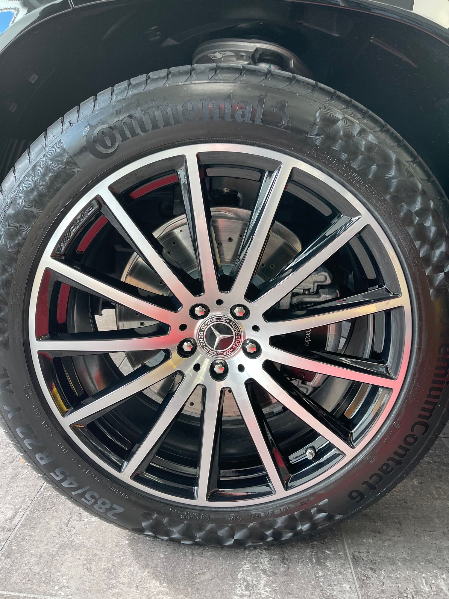

I just picked up my GLS2022 GLS with AMG Night package. It came with 22" AMG multispoke wheels and Conti Premium Contact 6 Summers and slotted rotors.
This is what i have on my car right now:
front tire: 285/45ZR22
front wheel : 9.5Jx22 ET45
rear tire: 325/40ZR22
rear wheel: 11.5Jx22 ET47

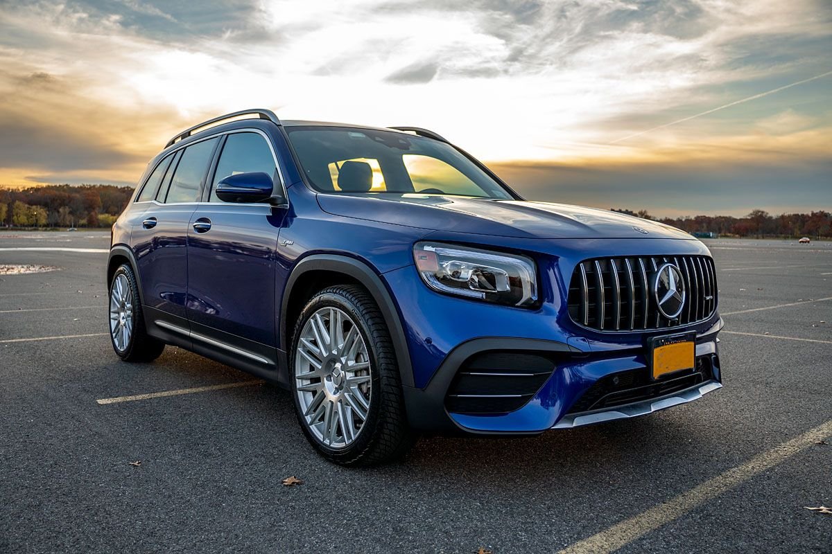

I am in NYC and my GLB came with the Conti 6 Summers also. I got Mandrus Estate wheels for winter tires for my GLB after seeing posts with the Mandrus wheels. Mandrus produces MB aftermarket wheels. Mine were produced in Malaysia, shipped from California by wheelpros. When I ordered the wheels, Mandrus website was offline to see their dealers. I found out later that Mandrus is owned by wheelpros. They both have the wheel options for your model and their recommended dealers to install the wheels. They have a good selection of wheels.
I chose wheels close to MB offset which is installed 9mm to outside of OEM. I got my Michelin PA 5 winter tires from Costco, but they didn't want to install them as they install their own aftermarket wheels and didn't have the TPMS for MB. So I went to my local MB repair shop for installation. I bought the MB caps from ebay and they fit to Mandrus wheels. My 3 OEM hub caps were already lost in NYC roads in 3 months of driving... Also Michelins PA5's are less harsher than Conti 6 summer tires...

My car with the Mandrus Estate and PA5 winter tires:

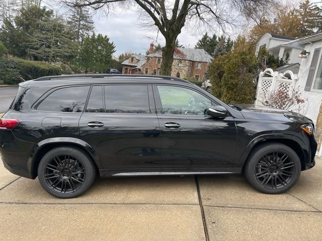

So This is my current setup:
And i think this setup works the best. The front will poke out a little bit by 25mm - but thats less than an inch only.
Tires -> CONTINENTAL VIKINGCONTACT 7 285/45R22
Wheels -> Mandrus Estate 22x9.5 5x112 +20mm Matte Black Wheel Rim 22" Inch
Using the willtheyfit.com, the rear seems perfect and the front just pokes out by an inch or so. (which i dont think i care that much unless there are mechanical issue to it.
I cannot find a place that will sell all these in one single place, so i may have to order them seperately.
What do you think about the setup?

It should be fine as long as the front wheels clear car frame at full turn... You might get more water/mud splash on the fronts... At the same time, you can rotate the tires easier. I don't know the other winter tires, but PA5 are directional so only rotation is on the same side with front to back...
You can ship the tires into any wheel installer... Also you need to get TPMS for the new set if the installation shop doesn't have them... I ended up in a MB indie repair shop... When I ordered the wheels, the lug nuts were separate. OEM lug nuts doesn't fit to Mandrus wheels. You need to order conical lug nuts. 27mm lug nuts fit to mine. You can check with GLS owners...

Thank yo for all of your help. i was able to put up the winter tires and did a trip with it. Extremely happy with my choice.
  • Mandrus Estate 22x9.5 with +40 offset.
  • Conti VikingContact 22" tires
  • M15 x 1.25 28mm lugs
  • 111 lb torque.
  • Convex socket from Amazon to take off my OEM lugs.
Thanks again.
