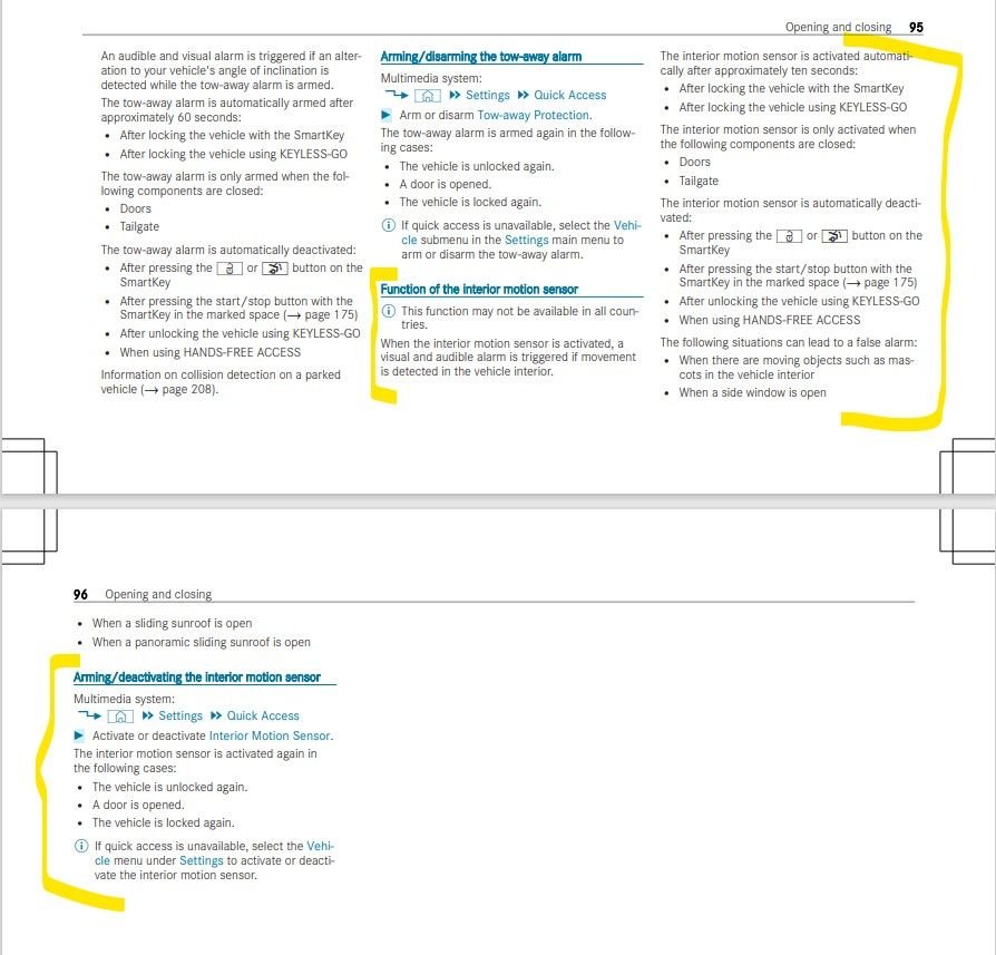

I fully understand why you want to do this. The problem is the interior motion sensor that is part of the anti-theft alarm. You have two options:
1: Turn off the interior motion sensor then lock the car with the FOB. Instruction on how to turn off the sensor are below. Note you will need to do this every time as the sensor will re-activate once you unlock and relock the car.
2: As other stated, if you fold the mirrors manually then use the lock button on the door to lock the doors and then turn off the car it should not activate the motion sensor.
Hope that helps.
