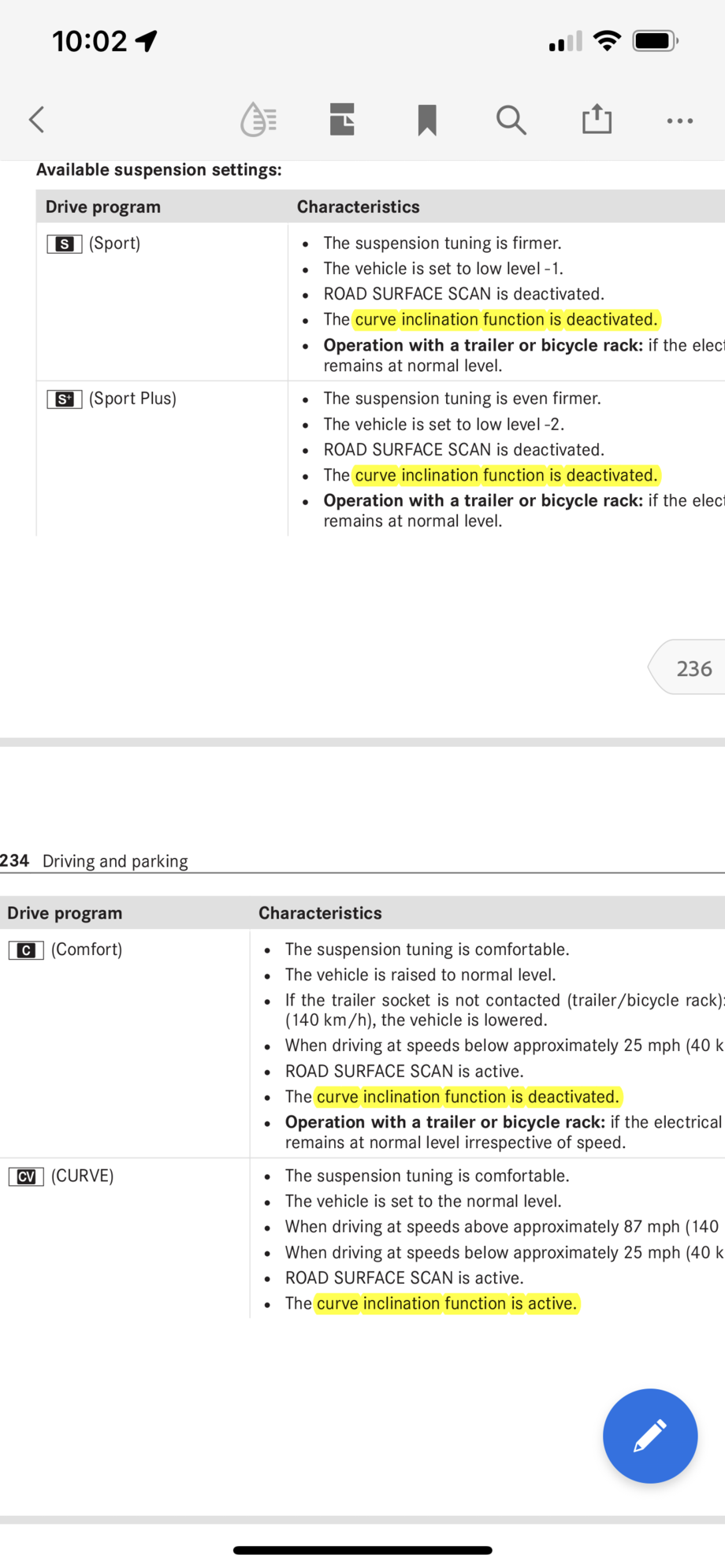

I agree with DJ and am all for the eABC but it’s worth noting I am a total sucker for car gizmos. I want it mostly because my wife scolds me for going around highway bends/curves to fast and it’s just because the higher center of gravity and flexible suspension makes SUV’s seem like they are going to tip over. The “curve inclination” feature that comes as part of the eABC definitely helps minimize that.
But it’s worth noting that the “curve inclination” feature of the eABC that causes it to lean into curves like a motorcycle is only active in “Curve” mode and not Comfort, Sport, Eco, etc. (see screen shot of user manual). I’m also pretty sure it’s only 3 degrees not 5 but can’t recall.
