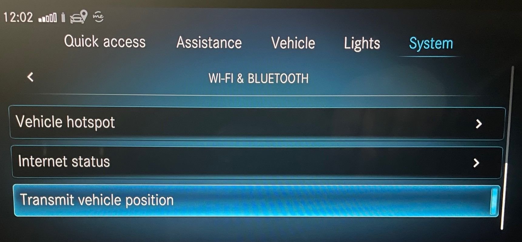

Head to
Settings - System - WiFi & Bluetooth
Scroll down to "Transmit Vehicle Position" and switch it off.

Thanks…unfortunately, that option is not on my version of MBUX! Any other ideas?
