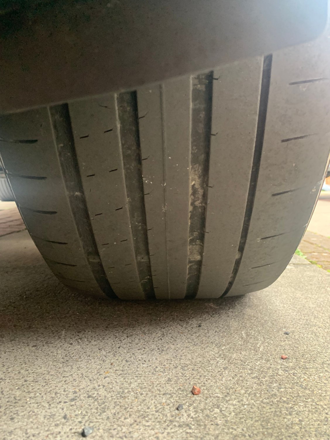

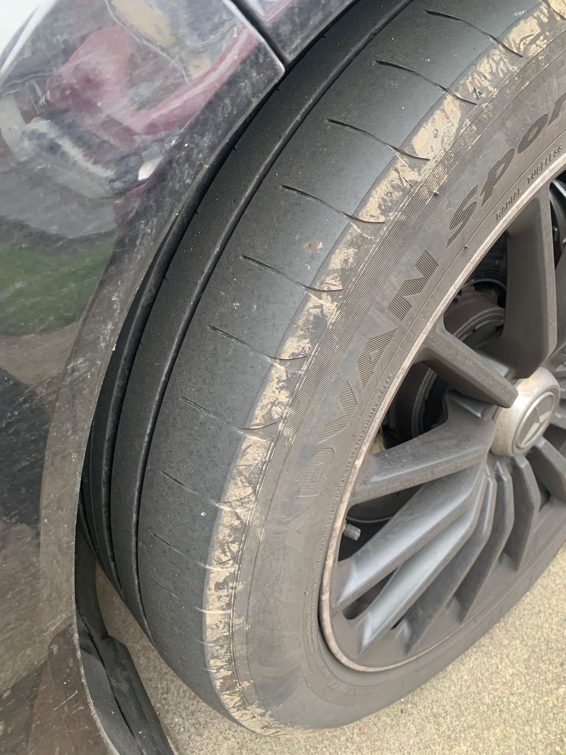

Hi guys
Just reviving the thread, the front tyres are down to less than 4mm in the centre now, rears above 5mm, but the fronts have worn heavily on the other edge, is that what you guys experienced or a suggestion of alignment issues? Wear fairly even centre to inner edge just outer edge that’s worn quicker, big heavy powerful car so not complaining just wanted to know what others had with their 22” wheels?
Thanks
Old Mar 9, 2024 | 02:33 PM
  #36
chassis's Avatar
Joined: Sep 2018
Posts: 14,707
Likes: 4,599
From: unbegrenzt
2017 GLE350 4MATIC
Excessive camber, wide tires and soft compound are the root causes. GL and GLS have been notorious for high tire consumption through the years.
The only changes possible are K-Mac camber links, harder compound tires or narrower tires which means a smaller wheel/tire combination.
"heavy car" has nothing to do with tire wear.

Heavy car definitely has something to do with tire wear. Tread life will be shorter the heavier the car is. It's something that a lot of EV drivers are finding out as the biggest maintenance cost are the tires.
Having said that, outer edge wear is generally a sign of too much toe in and it's not usually something that happens normally on an AMG. AMGs generally have more aggressive negative camber, so the inner edge tends to wear quicker on the front tires, not the outer edge. Definitely looks like your front tire is being rolled over its outer side. Are they inflated properly?

Originally Posted by carlosamg50
Hi guys
Thanks
It looks like you've been enjoying your car in the twisties.
To me, that doesn't look like excessive wear, compared to the rest of the tread. Probably 1 - 2/32nds more wear than the rest of the tire.
I had a lot more wear on my fronts than that, after only a few track days.
There's no evidence of feathering or other "out of alignment" tells.
Just get new tires, an alignment, and wear out the new set.😀
And yes, my fronts wore our before my rears. I don't drag race, but I do like attacking corners.
EV tire wear is from max torque at zero rpm. EV manufacturers are also likely cheaping-out on tires, as they do with everything else, to shave ounces of weight from the car to get a couple of hundred yards more range from the battery.
Suggest you read the voluminous quantity of posts on GL and GLS tire wear in the 164 and 166 sections. Camber, not toe, is the issue. It has been since 164.
Weight has nothing to do with tire wear in this case. Consider Class 8 trucks - tires are designed for the use case. Larger and wider tires as are more common today on passenger cars such as GLS and many others should see less tire wear with a larger area to distribute a not-much-different mass. But the reality is tire wear is essentially unchanged - it's terrible for MBs and AMG SUVs.

The reality is Front “Camber and Caster” along with Rear “Camber” has been eliminated. It is all to do with cost cutting and the ever increasing speed of new car assembly lines !
New car industry’s best kept secret - the often quoted reassuring “Full Front and Rear ‘4’ Wheel Alignment” IS NOW ONLY BASIC TOE - DIRECTIONAL ADJUSTMENT.
There being now only ONE SET CAMBER ANGLE - TO SUIT SHOWROOM HEIGHT CONDITIONS.
THE ONUS NOW BACK ON OWNERS TO FUND PREMATURE TIRE REPLACEMENT - caused through day to day commuting encountering high cambered roads with excess passengers side edge wear, wheel squat through load carrying or lowering. Fitting wide profile tires. With no longer this “ongoing adjustment capability” necessary to compensate for curb knock damage !
We have therefore taken on the role of manufacturing “Bolt-On” Front and Rear adjustment kits for over 30 makes and models.
W167/X incl. AMG FRONT Camber & Caster Kit - no special tools required or need for arm removal P/N 504216P $795.
REAR kit Camber & Extra Toe simply replaces rear upper control armsP/N 504226N $695.
Front & Rear DHL AIR Delivery Worldwide $60.
AUDI to VOLVO - K-MAC Experience Of Resolving OEM Suspension Shortcomings Since 1964 !

Ive covered approx 4k miles since I got it a couple of months ago, but 90% of that is my motorway commute rather than spirited twisty roads etc.
Inflatef correctly, well 1 psi more than the label tells me to set them at, and to be honest my GL63 & GLS63 before this 167 variant did not wear their tyres at all on the outer edge, and they were used much more on twisty roads as o worked elsewhere then. They wore tires real fast but not just the edge like the 167 has done.
The ride still feels like it rolls on the tyres and the treads are moving around on the tarmac, body fidgeting like there’s a light breeze hitting the car, when there isn’t, and needing to make light corrections to the steering to keep it in line, so if I decide to keep it I will get new tyres and an alignment done to check everything is set up right.
