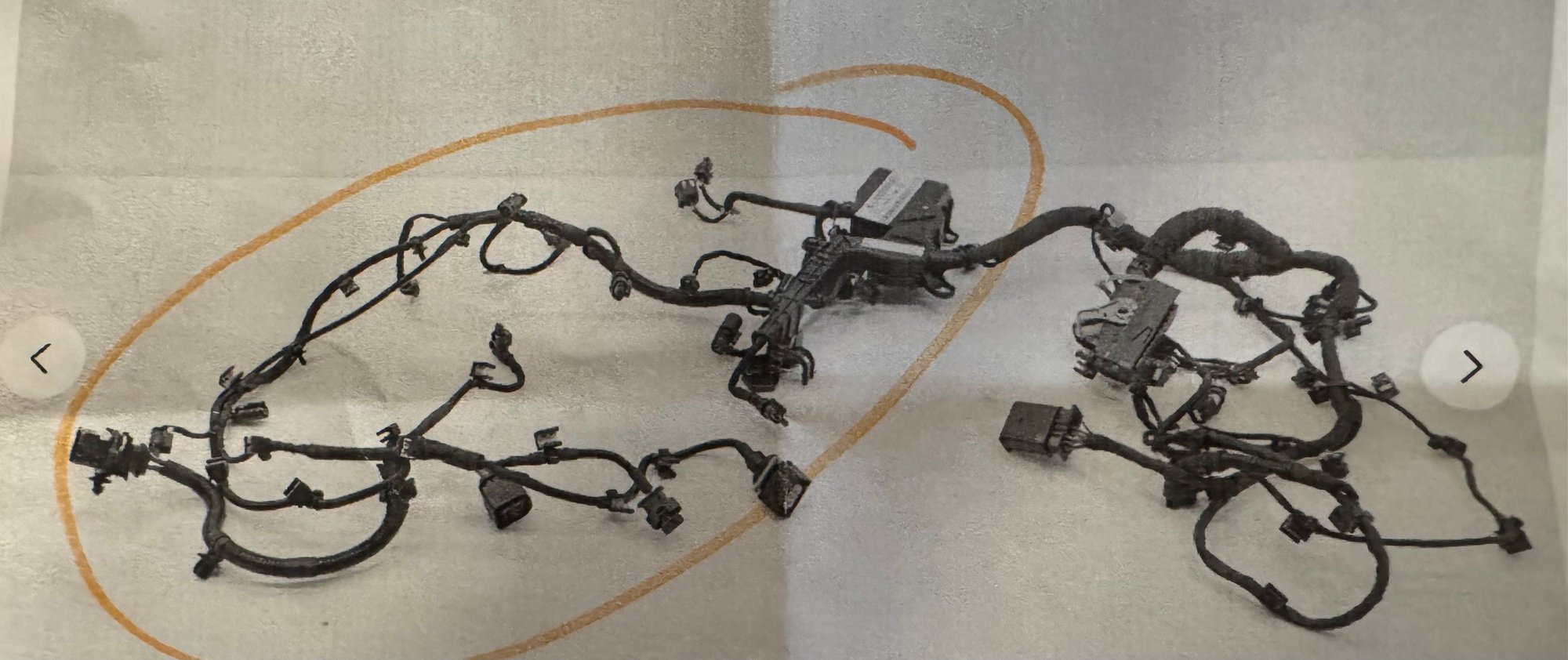

Our indie, Mellow Motors in the SF/Marin area, came up with a good strategy. Buy the $180 wiring harness replacement from MB and he’d cut it about halfway (at the point the harness disappears into the vehicle’s abyss) and splice it in at that point. He estimated a two-hour job if done that way.
I then called MB Customer Care prepared for an emphatic fight about them doing the right thing to cover a known issue. The agent put me on hold after hearing my summary and when she came back, she said “this will be covered by our Good Will Clause”. So, our local dealer will do the full replacement and MB will cover 100% of the cost. Incredible!
This faulty sheathing issue is clearly something they know about and I imagine have flagged as a borderline recall. Just wish I hadn’t already paid $500 to replace all the rubber boots that cover the plugs. I’ll still chalk this up as a major win and have a little more love for MB USA and a lot more for Mellow Motors who ate a few hours trying to patch disintegrating wiring.

Thanks to posts like this one, I discovered before changing the spark plugs in my 2019 CLS450 (70k km) that the wiring harness in my car was in the same condition.
I had previously purchased a complete wiring harness to replace it along with the spark plugs.
Unfortunately, I wasn't aware that the connector has a constant 12V and GND. I unplugged two connectors from the coils to assess their condition, doing so with the ignition off. During the wiring harness replacement, the battery was disconnected, except for the coil connectors at the beginning... After replacing the entire wiring harness – it was a tough job, with limited access to some connectors and very little space – it turned out that when I started the car, it was running on only 3 cylinders.
Errors:
After checking the new engine wiring and connections, everything pointed to the ECU. On the working coils, one of the pins connected to the ECU had a 2-ohm resistance to ground. On the non-working ones, there was no connection.
I opened the ECU and traced the paths. It turns out that both cylinder groups (3 cylinders each) are interconnected. Three pins are connected by a thicker trace going to the PCB’s through-hole. There’s plenty of space, so I assume the manufacturer designed this part as a fuse that would burn out in case of a short circuit.
After soldering, the car started without any errors.
Additionally, I installed insulation on the intake manifold and the catalyst to isolate the coils. I mounted a fiberglass mat with aluminum foil. The installation doesn’t disturb the designed airflow, but it perfectly insulates against heat. After removing the engine cover, the temperature in that area is noticeably lower.
Regarding the flap in the front intake – I wouldn’t remove it. It naturally opens while driving. During a standstill, its absence would do more harm than good – it acts as a check valve. When the radiator fan is running, air is pushed through the engine bay towards the windshield. If we remove it, the lower resistance in that area will cause the air to blow in the opposite direction, instead of flowing over the engine.
I would suggest to all m256 owners to check conditions of the harness and replace it in advance to avoid ECU damage.
