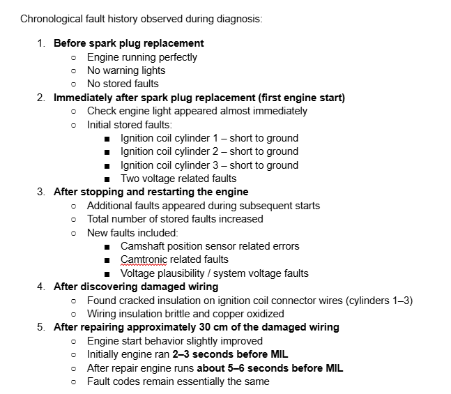

Hello everyone,
I'm new to this forum and I really appreciate the information shared in this and other threads. It's a shame I didn't check here before changing the spark plugs.
I'm currently in a situation similar to many of you, and I mention @Owczar’s post because it describes symptoms very similar to what I'm experiencing.
I have a 2019 AMG GT43 4-door with 60000 km. I changed the spark plugs like I’ve done before (I already did this job around 30000 km). I disconnected the coils, removed them, replaced the spark plugs and reinstalled everything. When I start the car, everything seems normal, but after 2–3 seconds the check engine light comes on. At first I thought maybe I left a connector loose, so I checked everything quickly and started the car again. Same thing: after 2–3 seconds the check engine light appears.
I connected a diagnostic tool and it shows fault codes related to shorts. Looking more closely at the connectors, I noticed that the wires for coils 1, 2 and 3 were very cracked where they join the coil connector. I disconnected the battery, opened the harness, and all four wires for each coil had partially lost their insulation. As many of you mentioned, the insulation breaks down because of the heat.
While waiting for the new harness (10–15 days delivery), I rebuilt about 20–25 cm of wiring from each coil using new wires and new connectors After clearing the faults, the short circuit + low voltage errors come back even with just the ignition on. When starting the engine now, it runs fine for about 5–6 seconds, but then the check engine light comes back on again.
After reading this thread, I’m starting to suspect there might be a short inside the ECU. In @Owczar’s thread I can’t see the images of the ECU repair anymore. Could they be re-uploaded?Also, if the ECU is damaged, would it make sense that the engine initially runs fine for 2–3 seconds?
and after repairing the harness it now runs for about 5–6 seconds before the fault appears?
Thanks in advance.
