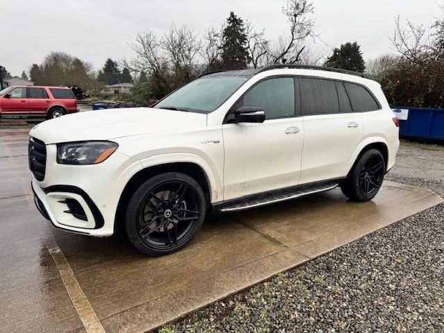

I appreciate all the responses... To update; I removed the 23" and purchased a set of 22" wheels which allowed for
many tire options... Landed on Pirelli Scorpion tires.

What size 22” wheels did you get?

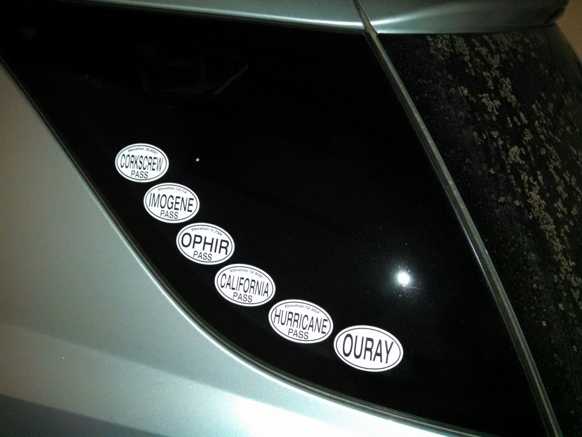

My 164 "Off Road" mode did a lot of work in the Rockies.
Stellar off road
The 164 was Stellar off road. Steel springs. Street tires.
Embarrassed Jeep Clubs. Fun.
The 166 was more like the S.S. Minnow.
Thread drift.
P.S. that was a rare moment that I used Stickers on a car. Our local Benz Club had an annual off-road weekend, and there was a sticker store in Ouray. I got caught up in the moment.

285/40/22 all corners
