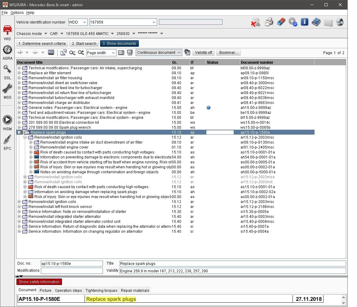

I'm in the middle of changing my plugs in a 2020 GLS450. I have access to WIS, but I cannot find anything about getting to plug #6 in the back. It is underneath what I assume is the intake to the turbo charger inlet and some sort of actuator.(waste gate maybe?). Below is (should be) a picture of what I am dealing with. That is a rag stuffed into the intake. I've been looking at it and WIS for 2 days and am a bit stuck. ANy help appreciated!!

Are you sure you drilled down deep enough into WIS? The top level document's right-hand most column references other WIS documents that provide further instructions.

I'm not fluent in WIS, but "I think" I have looked at the relevant available documents. I saw a comment on a different forum about task specific notes and Job Cards which may have more, but I could not find those. Here's what I pulled up below. Could I be filtered wrong? Thanks for the quick response,
You seem to have reached the bottom of the "WIS well" with the -1580E and -2003MSC documents which provide the helpful guidance "remove ignition coils" and "unscrew spark plugs". You might just have to nudge stuff out of the way to reach #6.

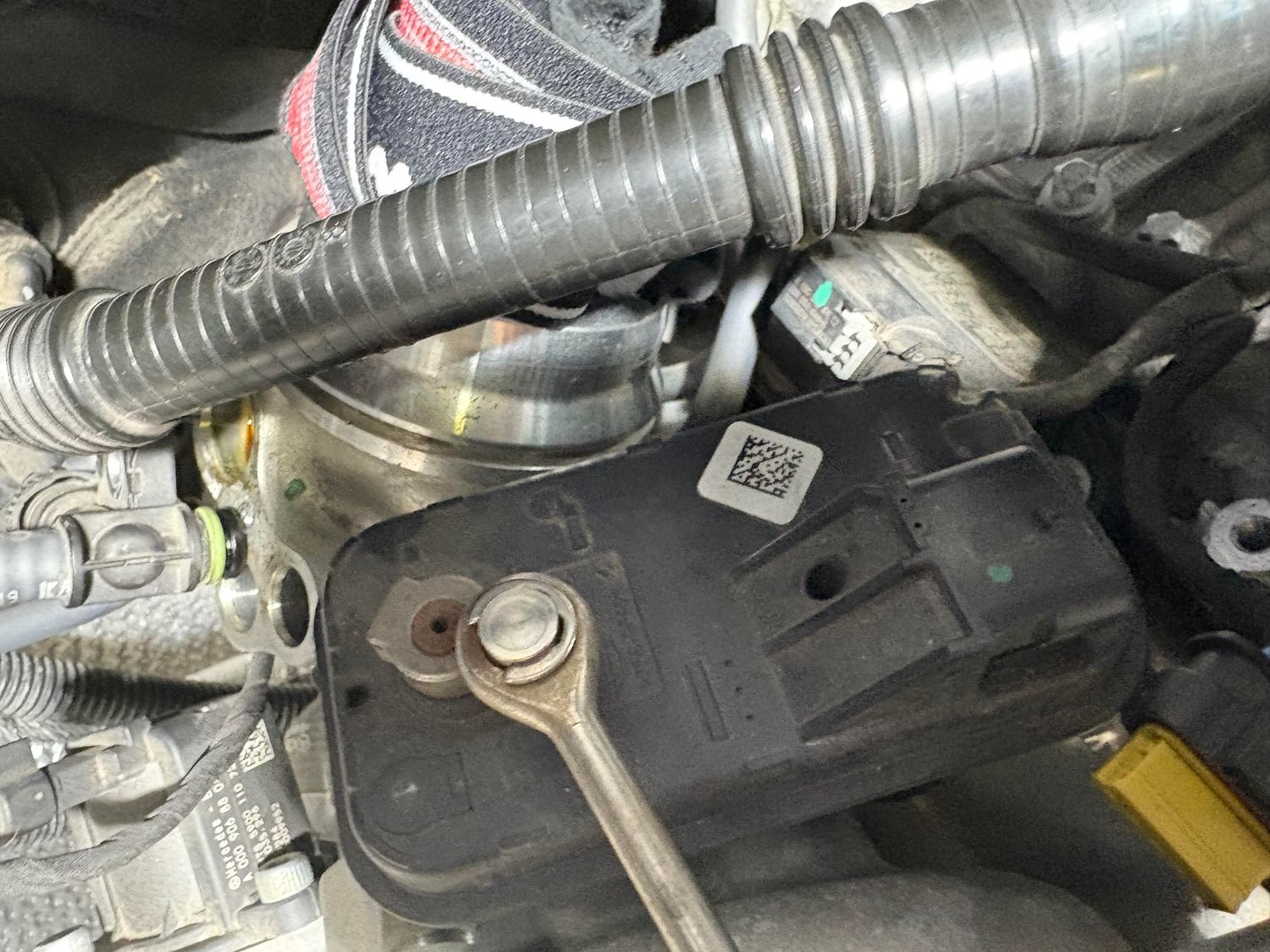

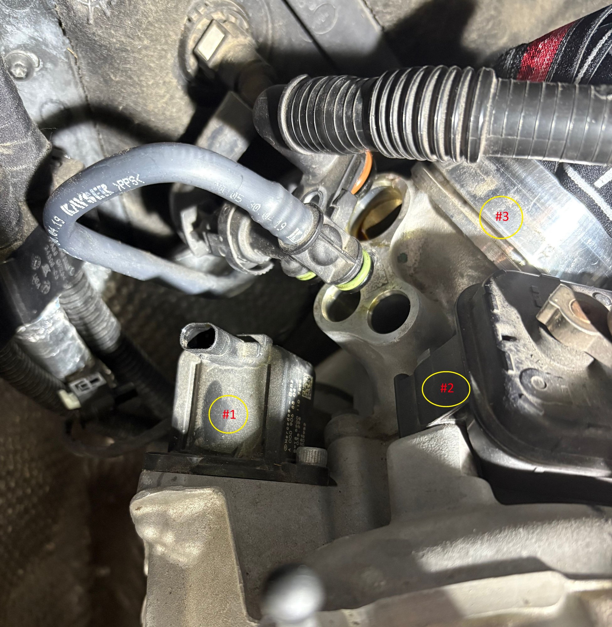

Changing the elusive spark plug #6
Just following up on my original question with the results. Short answer is that there is a reason they charge so much for a plug change on the GLS450. All of the real effort is in getting to plug number 6, which is a pain in the butt. After disconnecting all of the obvious oil lines, the process included first removing the divert air switchover valve (#1), then the actuator (#2) for the turbo (not proper name), and then the intake air duct (#3) for the turbo before you could even begin to fight with the coil and plug in minimum space. Moving #2 required getting to the 2 bolts underneath the back right side only viewable with bore scope. Then the second bolt on the intake is not accessible from above or below easily and required removal of the wheel well which didn't help that much. I relearned how to use WIS/ASRA though, so I got something out of it. Short story is it may be worth it to have the dealer or experienced GLS x167 Mechanic do it unless you have limitless free time, all the proper tools, a good working knowledge of WIS/ASRA and a lot of luck. Plus be extra careful with the wiring harness which I read is very prone to cracking and breaking ($$). I will not do it again. Makes the LX 600 start to look awful nice... just saying
Access to plug #6
Access to plug #6
