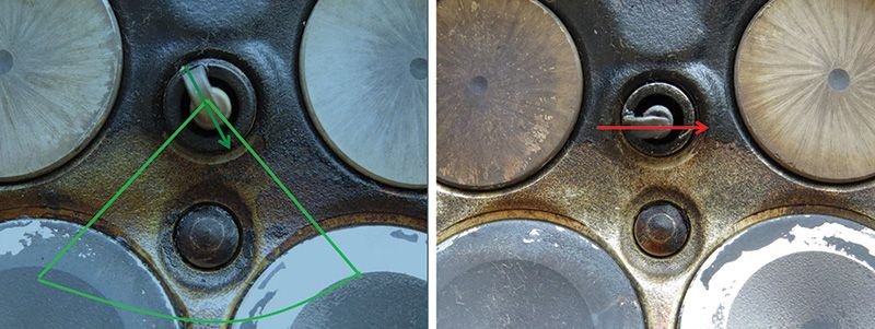

In another forum thread, there is discussion about spark plug indexing. While controversial generally, MB insists that indexing is critical on certain of its engines that use direct injection. MB branded plugs are designed to properly index when torqued to spec, and anti-seize would likely interfere with achieving this. The reference in #10 above has a link at the bottom to a MB technical paper that discusses indexing. It's cheap insurance to pay more for MB spark plugs every 50K miles to ensure it's done correctly.

From what I've read, people who want to index spark plugs that aren't indexed by design add spacing washers that achieve the orientation while maintaining the torque spec.
Any risks to doing that?

Ignore anything related to spark plug indexing and follow the steps below.
Buy new OEM spark plugs from the dealer
Remove old spark plugs
Install new spark plugs, torque to 23Nm
Done
