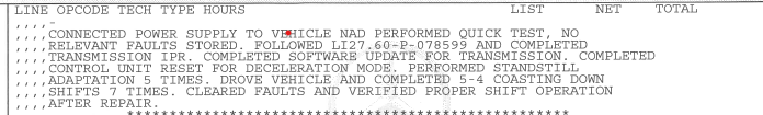

I had the Same issue with my 2024 GLS 450, I suggest you take it to dealership, there is a software update for this issue , and the dealership will also perform adaptations as part of the software update. Guess what after that its like a BUTTER , soft and smooth you will feel like a storm just Passed .
Good luck
Old May 20, 2025 | 05:56 PM
  #37
W205C43PFL's Avatar
Posts: 32,222
Likes: 6,281
Good luck
Do you mind posting the work order by chance? Thank you.

Shift adaptations? I wonder if they also performed stand still adaptation after the software update, as in the software update alone did not fix the issue?

Please find my work order description , with the below fix from dealer ship i can say that the issue is completely resolved
Old May 27, 2025 | 05:34 PM
  #43
rdornala's Avatar
Joined: Apr 2025
Posts: 30
Likes: 13
2026 GLS 450 4MATIC
Thanks for the work order, I wonder why the have to perform standstill adaptation 5 times.
Old May 28, 2025 | 03:24 PM
  #45
mikapen's Avatar
Joined: Oct 2009
Posts: 6,987
Likes: 2,187
From: Colorado
I think it's usually three to five times to verify it's accepted.
In practice, I don't think it's any different from the previous method that required two technicians, but they had to drive around to do it.
Thus the "stand still" moniker.
I see, that explains why forum members say it is a tedious process and patience is required.

My GlS450 is now butter smooth after everything.
but dealer did not. Give me any official documentation of the process.
nothing.
