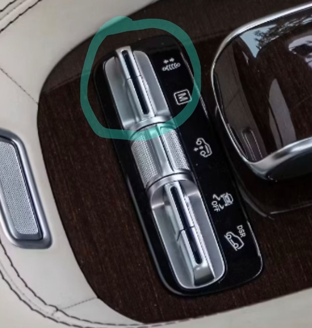

Look for these buttons.

Any 450 or 580 that has 5 switches will have E-ABC otherwise it will have 1 wide switch

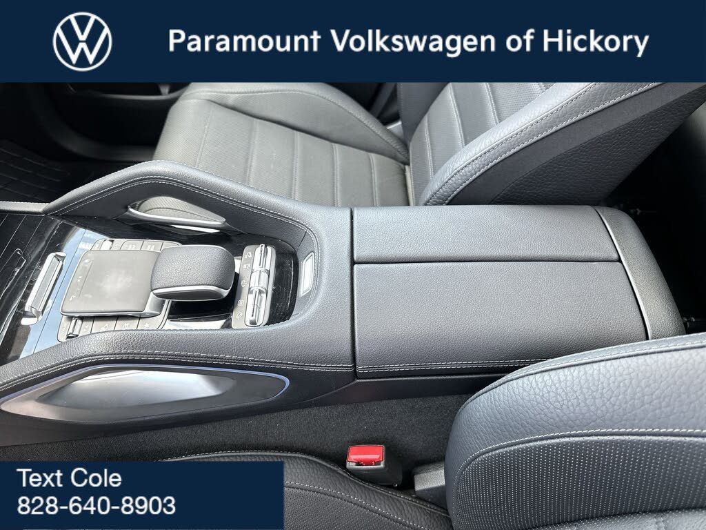

Thanks for this. I'm in the market for a gently used GLS580 and this option is hard to find. I did stumble on a car with these buttons, but when I cross checked the VIN it did not show the 490 option. What do you think could explain that? The car is a great deal because I don't think the dealer (not a MB dealer) knows the car has this very expensive option.
Edit: here is the Pic and the VIN
https://mb.vin/vin/b0e9814f5d550fdc8587127fc9342648/options/
489 = Air suspension, 490 is E-ABC. They are difficult to find.

Yeah but I thought the single button is the standard air suspension, but when you have the 5 button layout like the pic shows, that the E-active body control suspension. That's why I was confused with this car. Price implies, and VIN confirms, it just had standard suspension (489), but the pic shows it may have E-ABC (490).

The only way to be certain is ask them to put it in drive, put it in off-road drive setting, and then hit that suspension button (the one closest to the driver) while still in drive (brake can be applied), and see what pops up on the center screen. You should see the Recovery function (bounce mode) and controlling individual wheel.
The "Offroad Package$1,900" also has these same buttons so the mb.vin is right.
