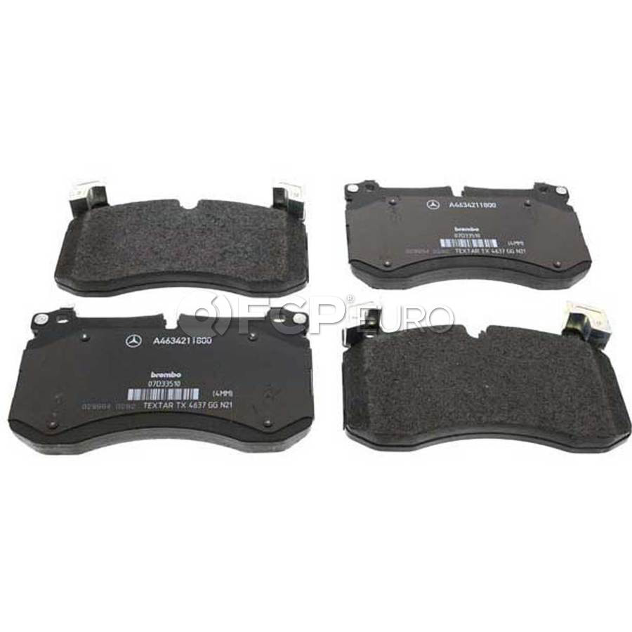

My 2020 GLS450 was a special order and has the larger U28 Sport Brake System(SPC) option. When I look at the Powerstop website there are no subcategories for the standard or Sport Brake. I would assume a larger brake pad is needed for the Sport Brake, but don’t see that option. What am I missing? Please educate me. Thanks.
Old Sep 18, 2025 | 08:17 AM
BeachTempest's Avatar
Joined: Feb 2023
Posts: 16
From: Haubstadt, IN
20 GLS450
Originally Posted by TNS550
Rather than start a new thread, a question about my situation….
Can you cross reference anything to the MB part numbers? Does FCP euro offer correct brakes that could be cross referenced? Here is what CHatGPT said:
————GPT———————
Short answer: I (CHatGPT) can’t find any PowerStop pads that are confirmed to fit the 2020 GLS450 with the special-order U28 “Sport/High-Power” brake system (SPC). PowerStop’s pads that are sold for the GLS450 (e.g., Z23-2237 front, Z23-2210 rear) are for the standard brake setup and listings don’t indicate U28 compatibility.What does fit U28 (examples for reference)
  • Rear OE pad set: Mercedes A000 420 73 03 (aka 000-420-73-03 / A0004207303) — specifically called out as “for cars with High Power Brake System (Code U28).” Aftermarket crosses include Brembo P 50 161, Zimmermann 22723.190.3, and Febi 178655.
Why I’m (CHatGPT) saying no on PowerStop for U28
  • Many parts retailers explicitly exclude U28 on their GLS/ GLE pad listings (they separate “standard” vs. U28 fitment), and PowerStop’s own generic pad pages don’t show a U28-specific fit. The U28 package uses larger rotors and different pad shapes, so the common PowerStop sets won’t match.
If you want a direct replacement today
  • Go OEM using A000 420 73 03 (rear) or use one of the cross-refs above. For the front, Mercedes has multiple superseding numbers depending on build date; the safest path is a VIN lookup with a Mercedes parts desk to pull the U28-specific front pad part number for that exact car. (Retailer catalogs show this variation and often hide U28 under separate part numbers.)
If you still want PowerStop
  • I recommend double-checking with PowerStop using their Brake Finder (they’ll tell you by VIN/sub-option). As of now, their public pad/kit pages don’t list an application that explicitly includes U28 for the 2020 GLS450.
Want me (CHatGPT) to try to pin down the front U28 pad part number for that specific VIN or build date? I can hunt it down and then see which premium aftermarket brands (Brembo/Zimmermann/TRW/etc.) carry it.
————- End of GPT——————
As always double check any part numbers before ordering anything based on GPT, but this should at least give you some leads to pursue. Hope that helped.
