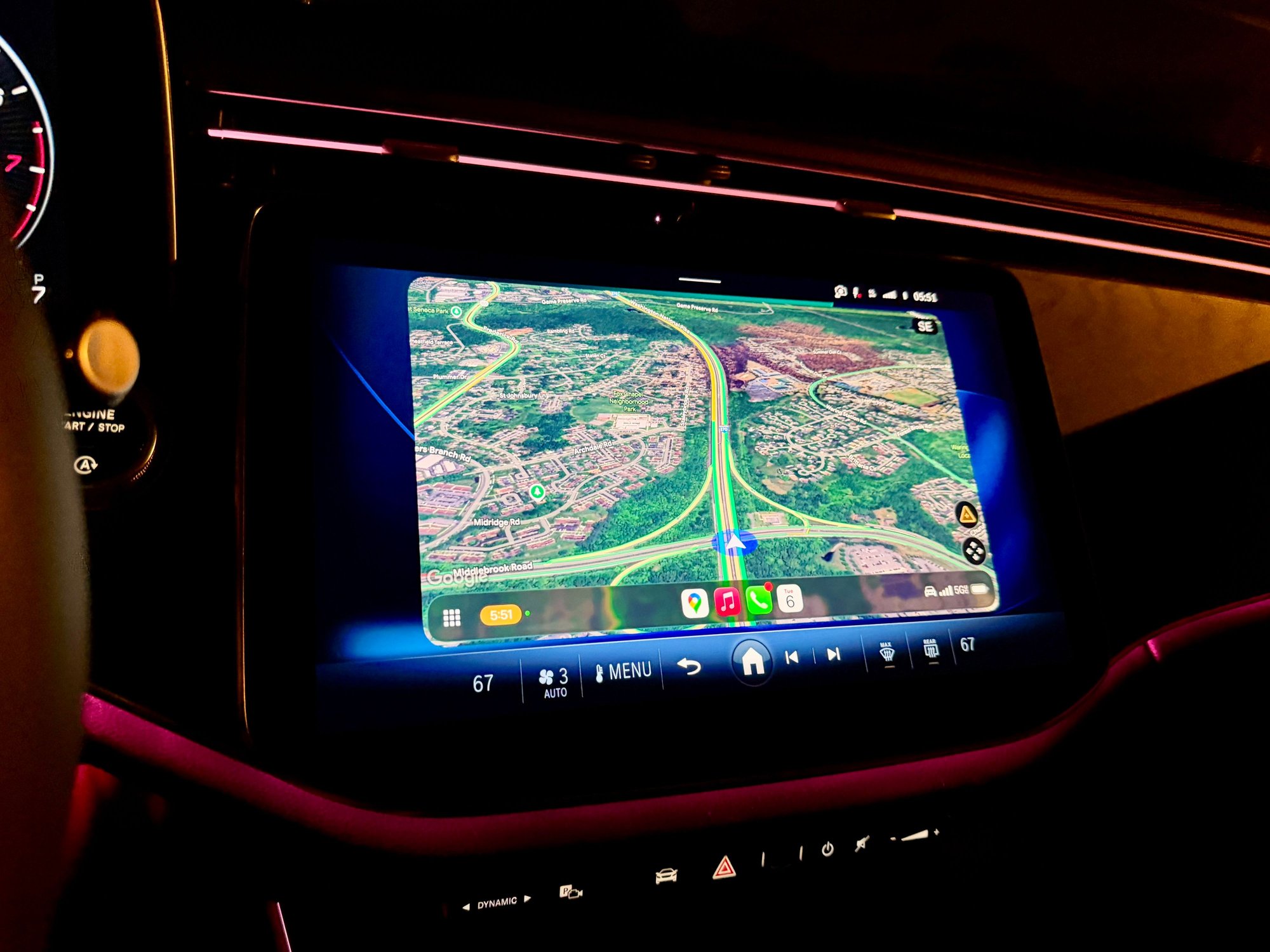

I have an E350 loaner, my S580 is in for the 20k B service. I'm surprised how much I like it. I gotta say, I optioned up an E450 with ALL the options, nappa leather, air suspension, all of it...$97k, hard to say my S580 is worth $43,000 more.
@S_W222 Carplay though...not full screen:

Wow man.. is this the same in your W223? But it is a big screen though.
I think the W223 is edge to edge.
This is a bummer though in the E class, I just don’t understand why.

No, the S580 is fullscreen, well except for the climate section at the bottom. Its the portrait screen though, not the landscape screen like the E
Honestly though I use MBUX more than CarPlay because it works so much better, COMAND in the 222 I used only CarPlay. I play music directly through MBUX because the sound quality is better and display the native MB satellite nav map.

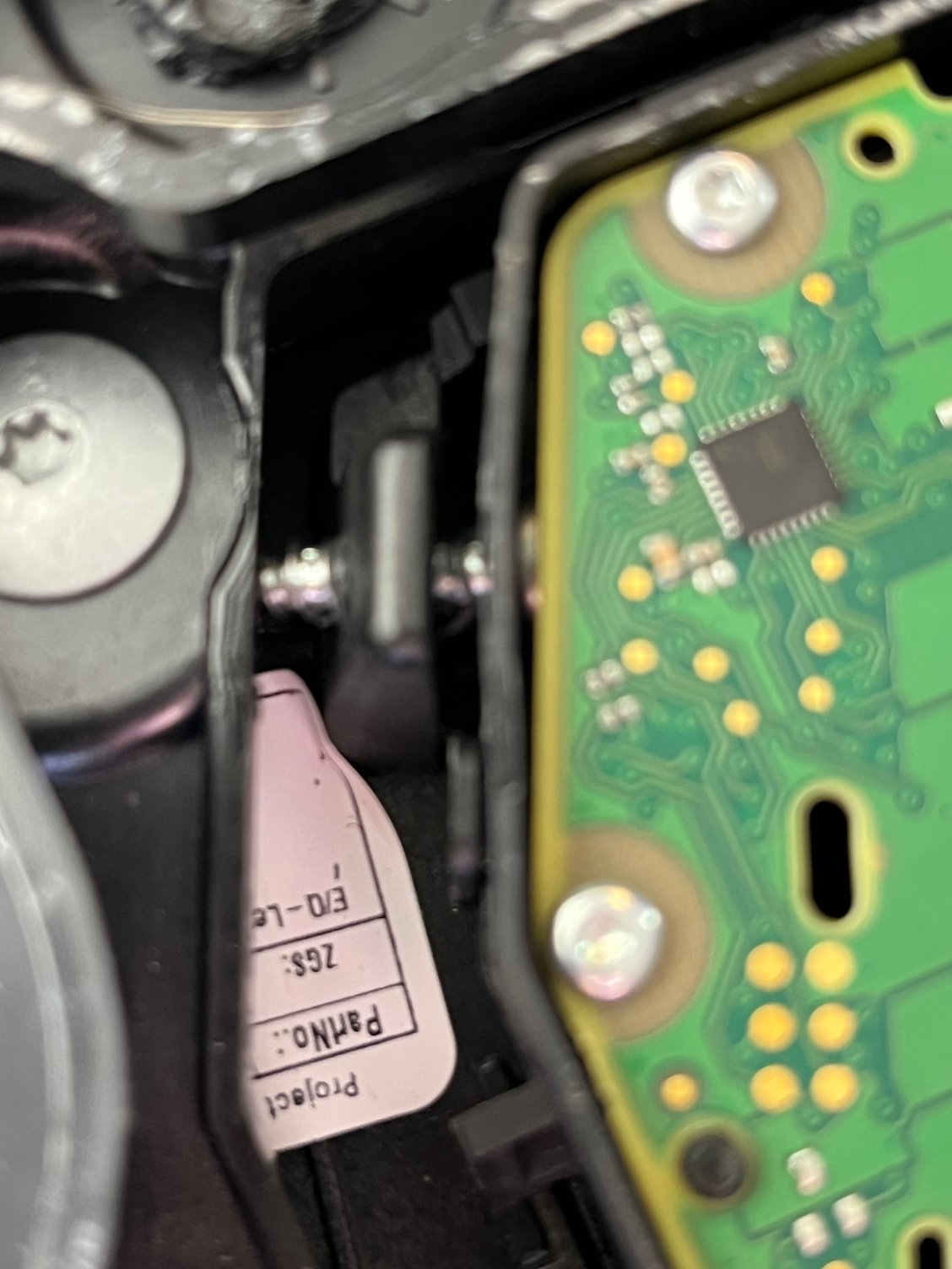

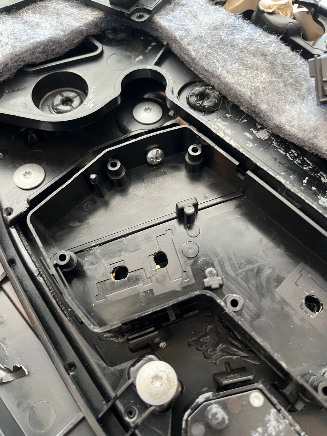

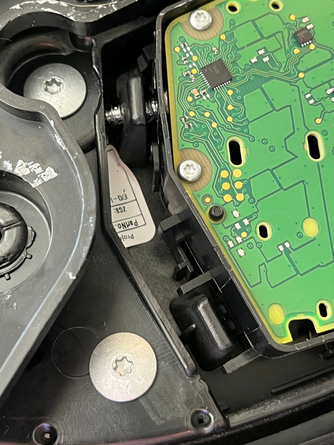

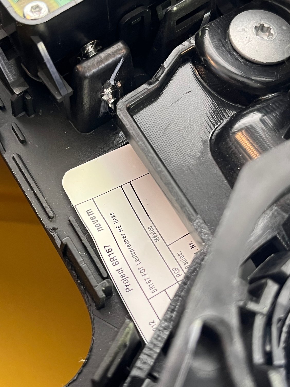

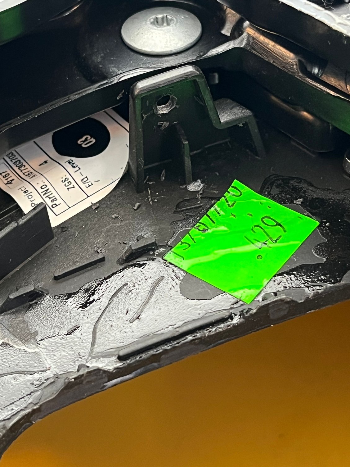

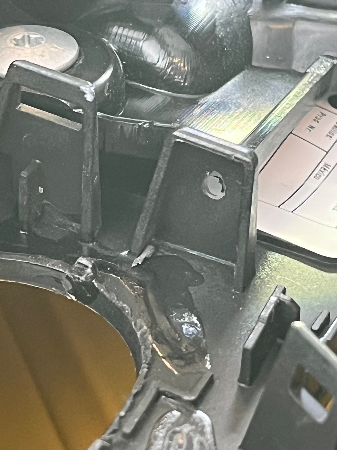

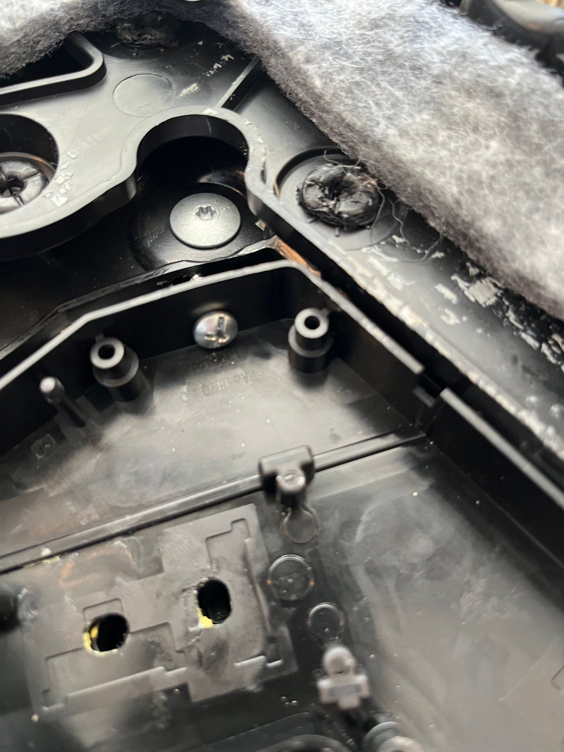

Since I started this one, which went basically all over the map, I wanted to circle back with a final fix that will ensure it never happens again. Score one for MacGyver. Seeing as how MB has publicly stated they want to go back to using more screws.....
I guarantee you, this car could hit an aircraft carrier at 150mph, and that rear seat control panel will still be there. There is no way it's falling out again now, and I'm not out hundreds for a new one with the same cheap plastic clips. This is SOLID to the door panel. You can see my previous failed attempt with superglue residue on the plastic.
How:
Take the door off and disconnections (YouTube it, it's on there, very simple).
Take the panel off the back of the control module for the seats.
Pre-drill the holes through the module frame into the nearby post.
Screw them together.
Put back together.
Enjoy.
Took me all of 30 minutes to do.
Very important to pre-drill the holes so you don't split the plastic with the screw of choice.

Nice lol. How it should have been done from the factory.
