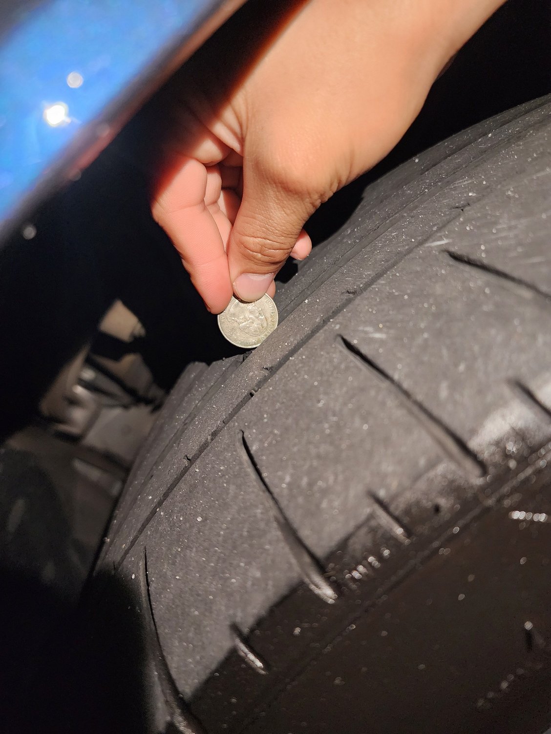

Do I need new tires?
Not very sure of this...
2024 GLS with 11.8k miles...
Dealer insisted this tires will last 10k+ miles...
but i think this thread is very loow

Look pretty worn. Did you check depth by the wear indicators ?
thread depth is around 4mm...
certain placess it was 4/32 and other 2/32.. more less
almost leveled to wear bars...
But man 3k in tiress iss so much.. for this 23in tires
Is the depth variation across the tread or around the circumference?
across the thread.

At 2/32", I'd be shopping for new tires.
In the summer, I'm shopping at 4/32". Anything less invites aquaplaning.
As winter approaches, I'm shopping at 5/32". Which is where I am today, buying new winters.
I'll remount these All Seasons next summer, for another 1 - 2/32"

I'll be shopping come spring for new tires. While I'm at 6/32", I'm also at 6+ years. Just mounted a set of Nokian Outpost nAT's on my Wrangler, but haven't had enough snow to give them a workout.

replace for sure
The AMG (All Money Gone) guys called, said to get your own box of Kleenex...
Jokes aside - this is unfortunate not uncommon on those tires. The AMG guys typically are looking at new tires with nearly every oil change, they only last around 10k miles.
