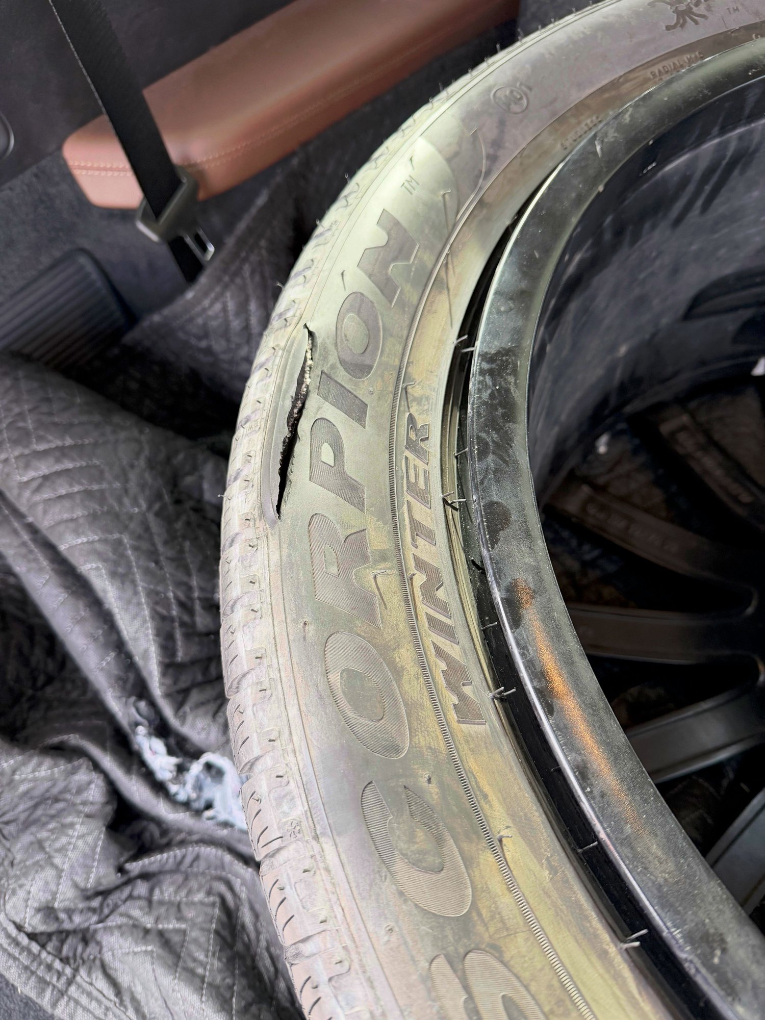

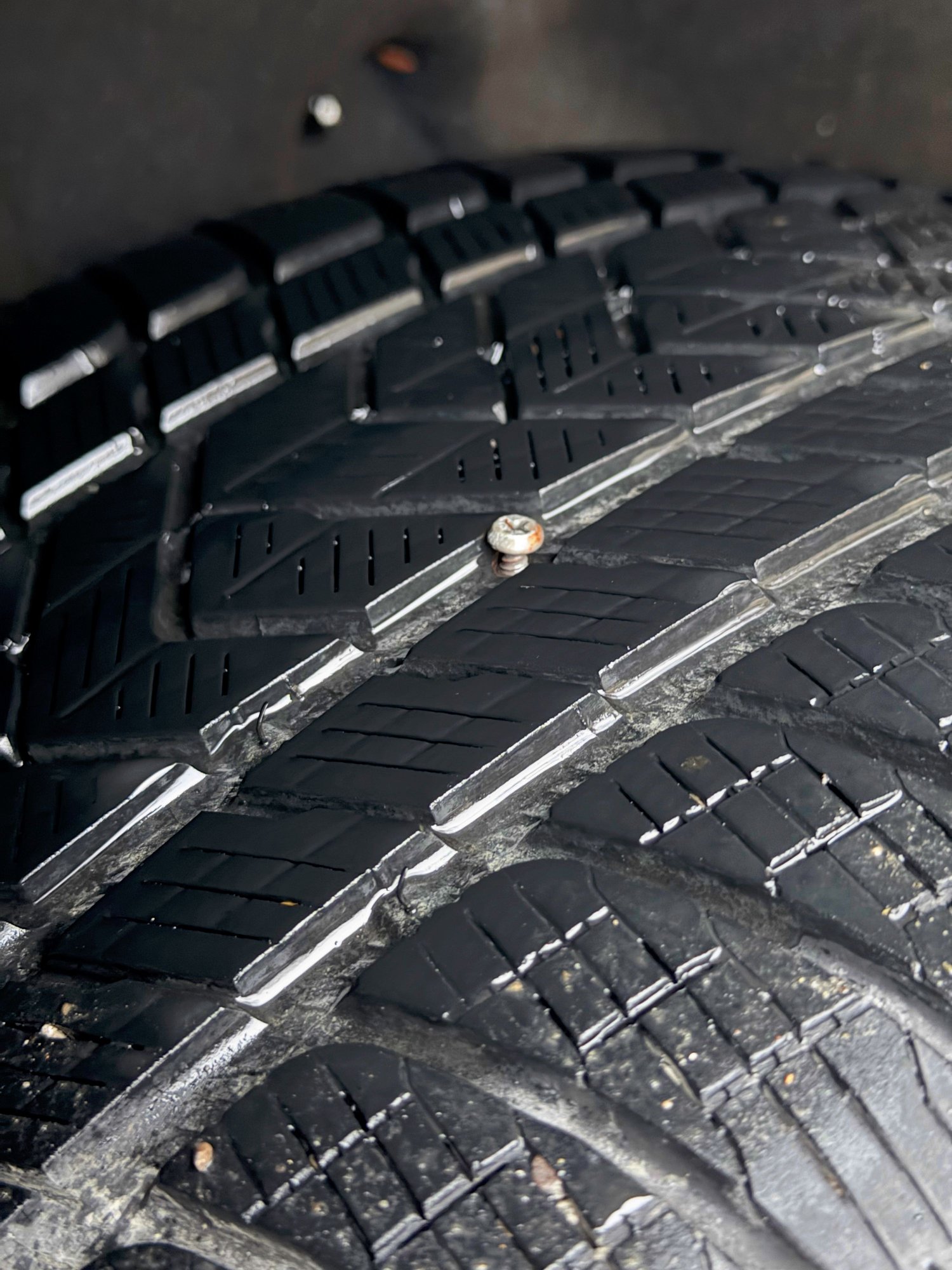

I noticed a screw in my tire when washing my car in my driveway, so I immediately swapped to the spare and brought the damaged tire to the local tire store just down the road from me that has 37 locations in the state.
They called me to tell me that the screw damage was repaired, but when remounting the tire it can't hold air because of a huge cut in the sidewall. I looked over the tire before brining it in, there was no huge cut. I was driving on it with 37 psi in it.
I drive over to the Mercedes dealership and their tire service advisor said he has accidentally made the same mistake when he worked at the other popular local tire chain with 58 locations in the region. He said with these wide 325mm tires, when depressurizing them to dismount them, you have to wait several minutes for all of the air to escape, otherwise the bead will not unseat easily and the tire shovel on the tire machine that pushes the tire off the bead will slice through the sidewall. He said the tire will still dismount, so sometimes you might not notice until you go to remount.
It's $1,017.68 including tax at the dealership to replace the tire. I'm negotiating with the tire shop now for them to replace the tire at their cost.
