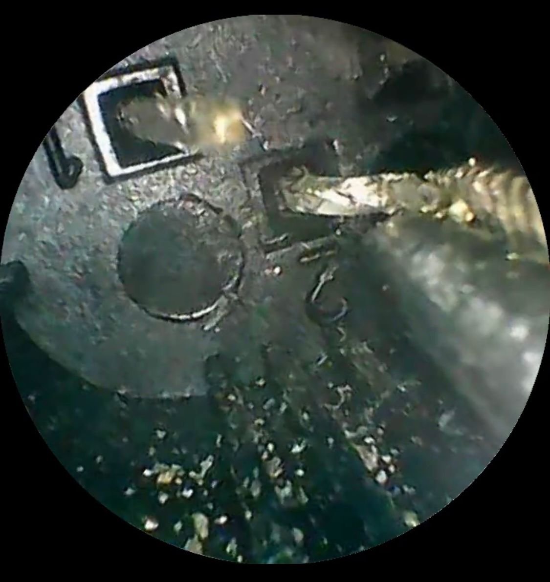

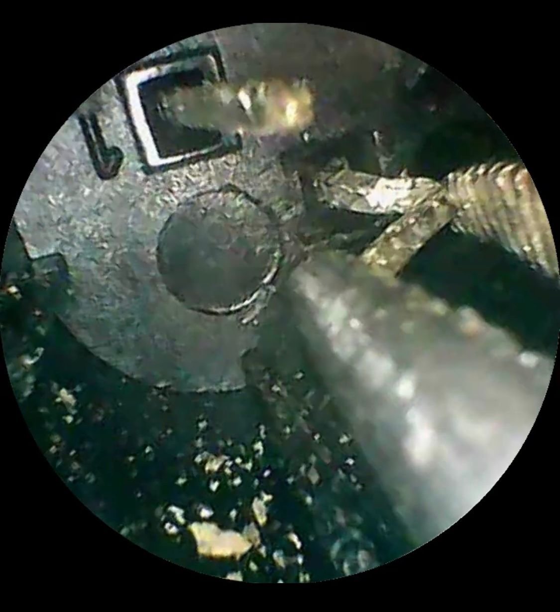

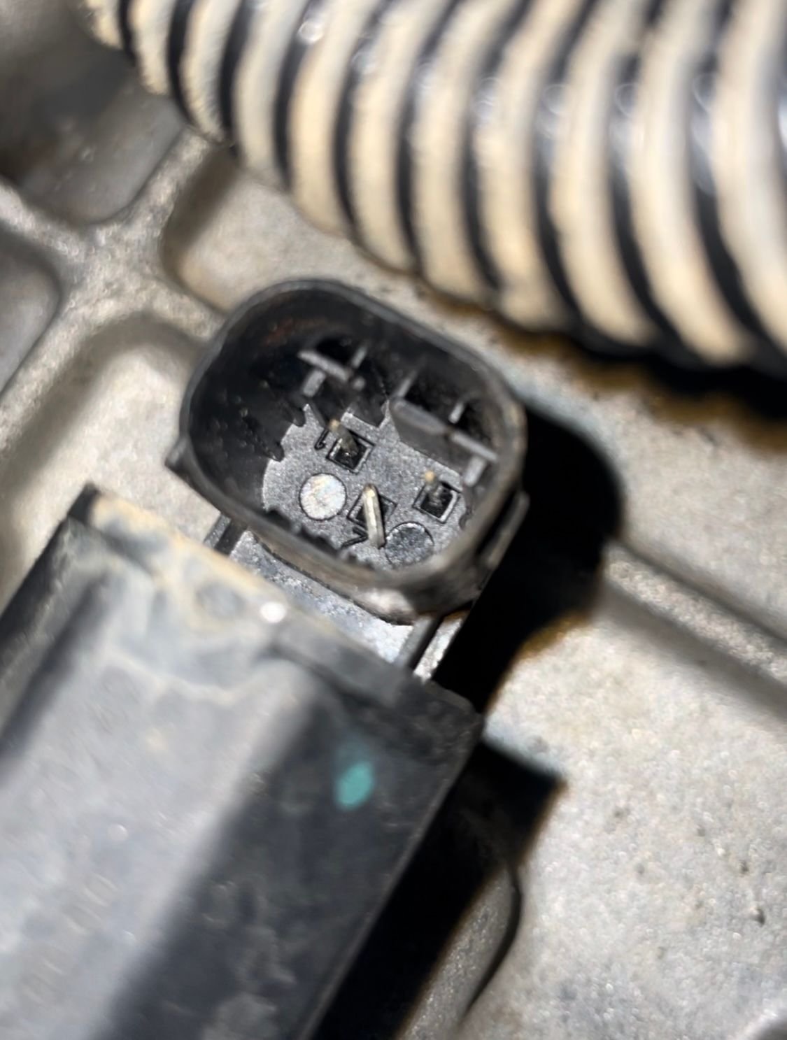

Well my ml500 has had the oil light on solid for 800 miles since I’ve rebuilt the m113 engine for it . I tripped checked oil level with dip stick & it was fine . The dash would not give me a reading and stay stuck on the lines . car ran like a champ & idles so smooth it’s hard to tell that it’s even running . After investigating & hoping I didn’t have to replace the sensor 🤯 I found that the lower middle pin on the sensor was bent ! I tried my best to straighten it with my pencil bore scope camera & pair of dental needle pliers . Very hard to reach area right behind my the alternator . I ended up shoving a staple into the plug end to bridge the gap & make some sort of connection & it worked like a charm . Oil light gone & I can now read level on the dash . Here are some pics of the bent pin with my phone & pencil scope cam
Initial discovery of the bent pin , Shot with iPhone
Me getting to it finally after 15 minutes of playing twister with my arms & wrists to get in there using pencil scope in left hand & dental pliers in right hand
Me giving it some pressure
It straightened up a bit but ultimately I had to bend it completely downward so I can plug in the connector plug with the staple bent downward also to avoid short circuits
