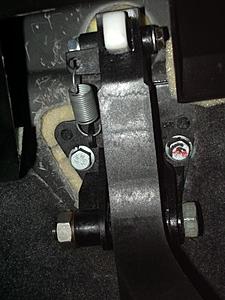

Gas Pedal Loose????Wiggles?
okay, i know i have pissed off a couple of members on this forum, im not asking you to help if you dont want to..
But anyways, Have anyone experience this problem?
Its been like that for the pass 3-4 years, but i just realize that its really pissing me off that it wiggles and stuff,
Does anyone know how to fix it? is there a screw i can tighten or is it just like that?
thanks suggestions would be great why this happen..

i can move mine about 5cm each side maybe less,

There is a plastic pin that holds the gas pedal in place. Removing that plastic pin and putting a bolt with a nut at the end solves that "loose gas pedal". Here are the pictures some one else had posted...

WOw, thanks alot bro
