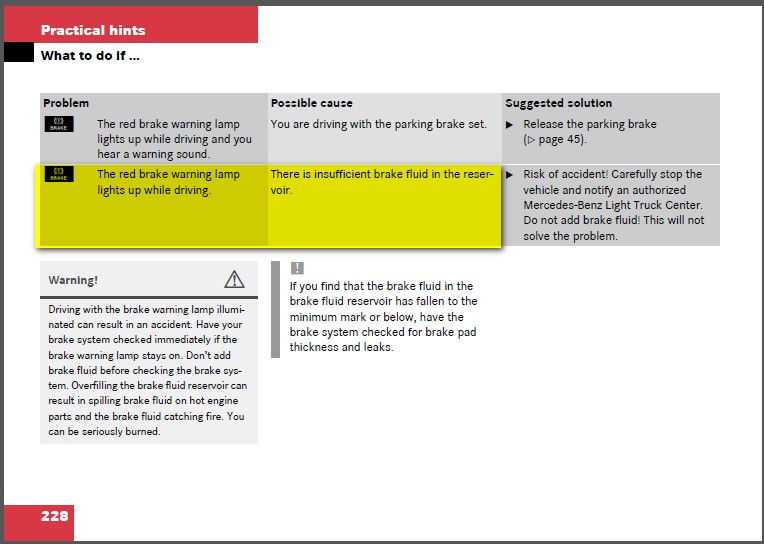

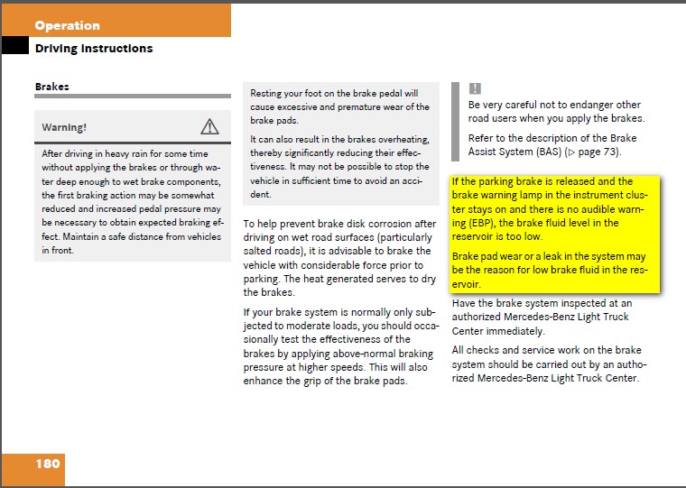

I am assuming that you are referring to the red BRAKE indicator lamp. If that is the case, then that is an indication that you need brakes to be replaced because the fluid level has gone down.
It is also to alert you that there is insufficient brake fluid, the parking brake is on or you have a problem with the EBP system (which has to do with the rear brakes).
All of this is in your owner's manual.
Attached Thumbnails Brake light comes on after brakes installed-2011-11-04_091048.jpg   Brake light comes on after brakes installed-2011-11-04_091532.jpg

Thanks for the reply. The light coming on is the yellow brake indicator lamp that comes on when brakes are worn. I know the rear brakes are okay. And, the front pads and sensors are brand new.
