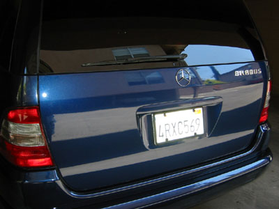

any before and after pics??
Old Jun 30, 2003 | 02:38 AM
andaya's Avatar
Joined: Nov 2001
Posts: 237
From: California
99 ML 430
no ML 430 emblem
p
Attached Thumbnails Taking off the ML430 emblem, any easy method?-img_2925.jpg
