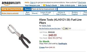

Any fuel filter 2002 and after have the most difficult fuel lines to release. Spray the entire yellow area on each connector with canned air to remove all dirt and debris. Then spray the connector with WD40 or Liquid Wrench. Many times it is difficult to move these tabs, which was a terrible design.
Then remove all the connectors on the right side of the filter and then lastly the feed line on the left.
You can then try to remove the lines by sliding both knurled pads downward (red arrow) and then removing the filter. The problem could arise that you cannot hold both at the same time and remove the filter without someone else to help.
This is where the tool comes in. Place the ends of the tool on the upper and lower smooth pads (green arrow) and apply slight pressure and at the same time slide the tool to push both knurled pads downwards.
Do not damage or mangle the feed line connector. If you do you will have to replace the one piece line that runs the entire length of the truck, which is not easy.
