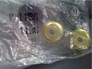

After you buy them, check the package which should include the standard two flat washers and two bushings, along with an adapter washer, especially for M/B.
If they are not included, call Monroe Engineering Dept. at 734-384-7809 and ask them to send you the adapter washers, part #1710661.
