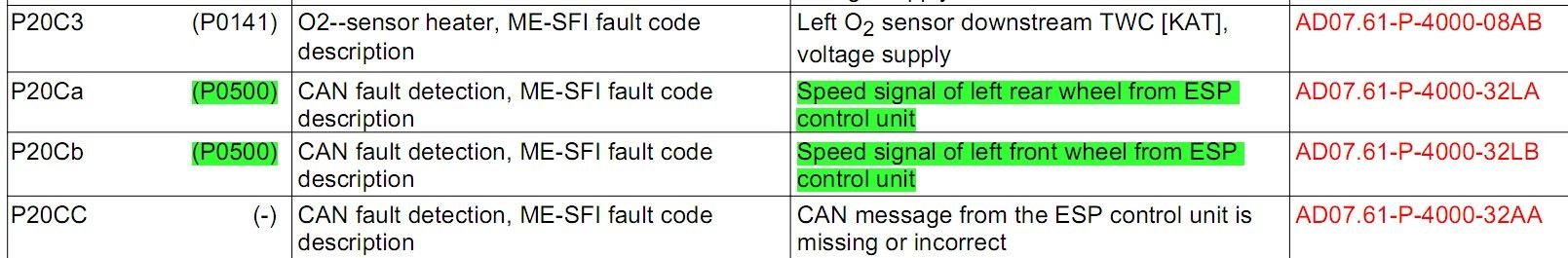

Code P0500 has nothing to do with the brake light switch. It refers to the left rear wheel speed sensor not sending a CAN signal to the ESP Cont. Module.

Look for code C1102 in ESP Module.
