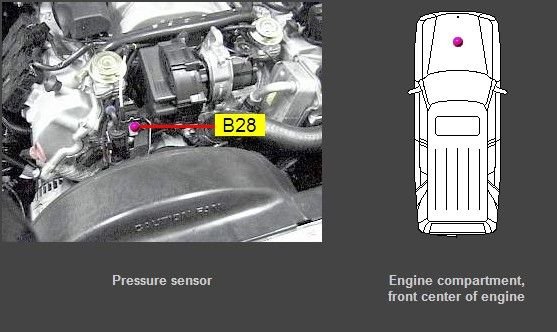

For code P0105, check the wiring at the MAP sensor.
