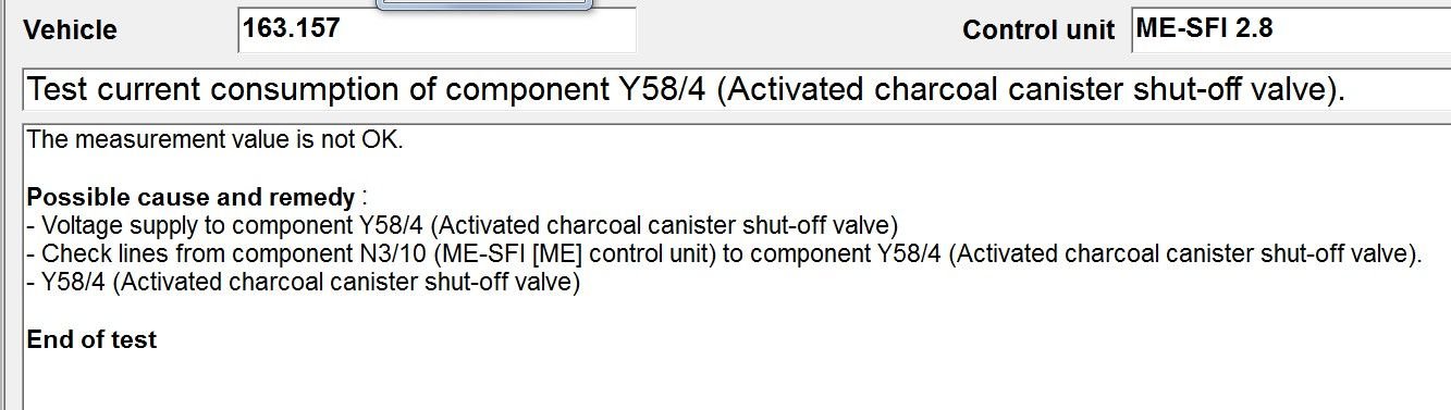

The saga continues:
Received a call from the dealer stating that they had a bad batch of fuel tank pressure sensors and that they were refunding my money. So I ordered a new one online and installed it.
Drove around for a few days and didn't get any check engine light! I was pretty excited.
Except now I'm getting a p0446 code!
Any idea what in the world is going on?

Old Dec 22, 2020 | 10:27 AM
norcalcasey's Avatar
Joined: Apr 2018
Posts: 223
Likes: 16
From: Bloomington IL
2006 C55, 2004 ML350
Yeah I did. It was with a used unit but it works when I give it 12v on a bench test. Can I test the wiring to make sure the car is getting 12v to it?
​​​​​​Edit: this appears to be related to the new fuel tank pressure sensor. The old unit would measure around 2.8-3.2v and the new one is measuring around 1.8-2.2V
​​​​​​What is the correct reading?

This is not about the fuel tank pressure sensor. It is about Charcoal Canister Shut-off Valve.
Go to the ECM module and locate conn.. 5 and 4. Then find the appropriate wires in the PDF and test the wires for voltage and then amps.
Do not remove the connectors as it will store other codes.

I spoke with the Master tech at the dealer and he said p0446 will throw if there's a voltage irregularity with the EVAP system, including the fuel tank pressure sensor.
I mentioned the new code and he said that he toggled the canister with his computer at the dealer and it worked fine. So it's likely not that.
I went back to the old sensor we will see what happens.
