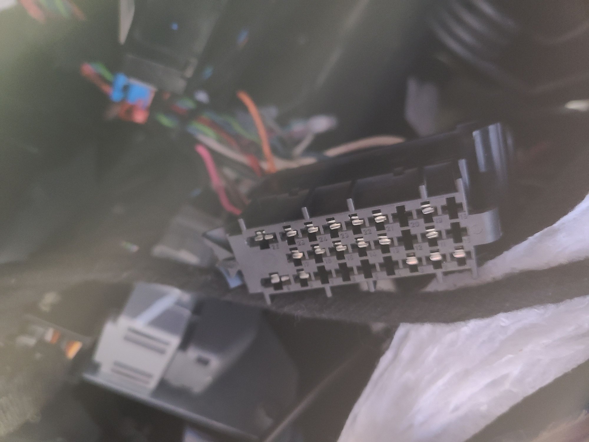

I found this connector unplugged under the dash. Looked like 3 wires were cut and loose. Others had splices in them. Didn't look like something the factory would do. Any possibility this could have anything to do with the nonsense I'm seeing?

Look at that component with a bright light for the part #. It will start with Axxx xxx xx xx.
I believe that is the EAM.
