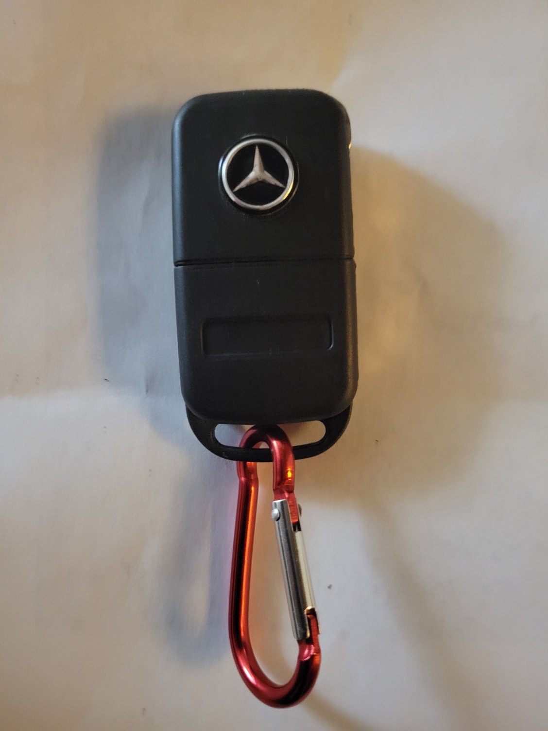

Right. Locksmith made it happen with a laptop and RF device placed on the drivers seat and ODBII plugged in. Didn't take long and remote worked flawlessly. I tried not to hover around but locksmith was happy to talk about the kit and how it's used. I was impressed by how smart and solid/secure it all was, the guy knew his stuff and the toolkit looked well engineered. Especially interesting because the MB dealership had said "impossible." All buttons function, it's great, I now have 3 working new fobs that are the same as the original, plus two secondary keys from MB. I took the battery door off my original and snapped it on the new one since original had the "star" logo. Other than that remotes are identical, though I used some super glue at the plastic shell's equatorial seam. No problem and I just did it to make it ultra durable and contain the force of the spring mechanism/ignition twist.

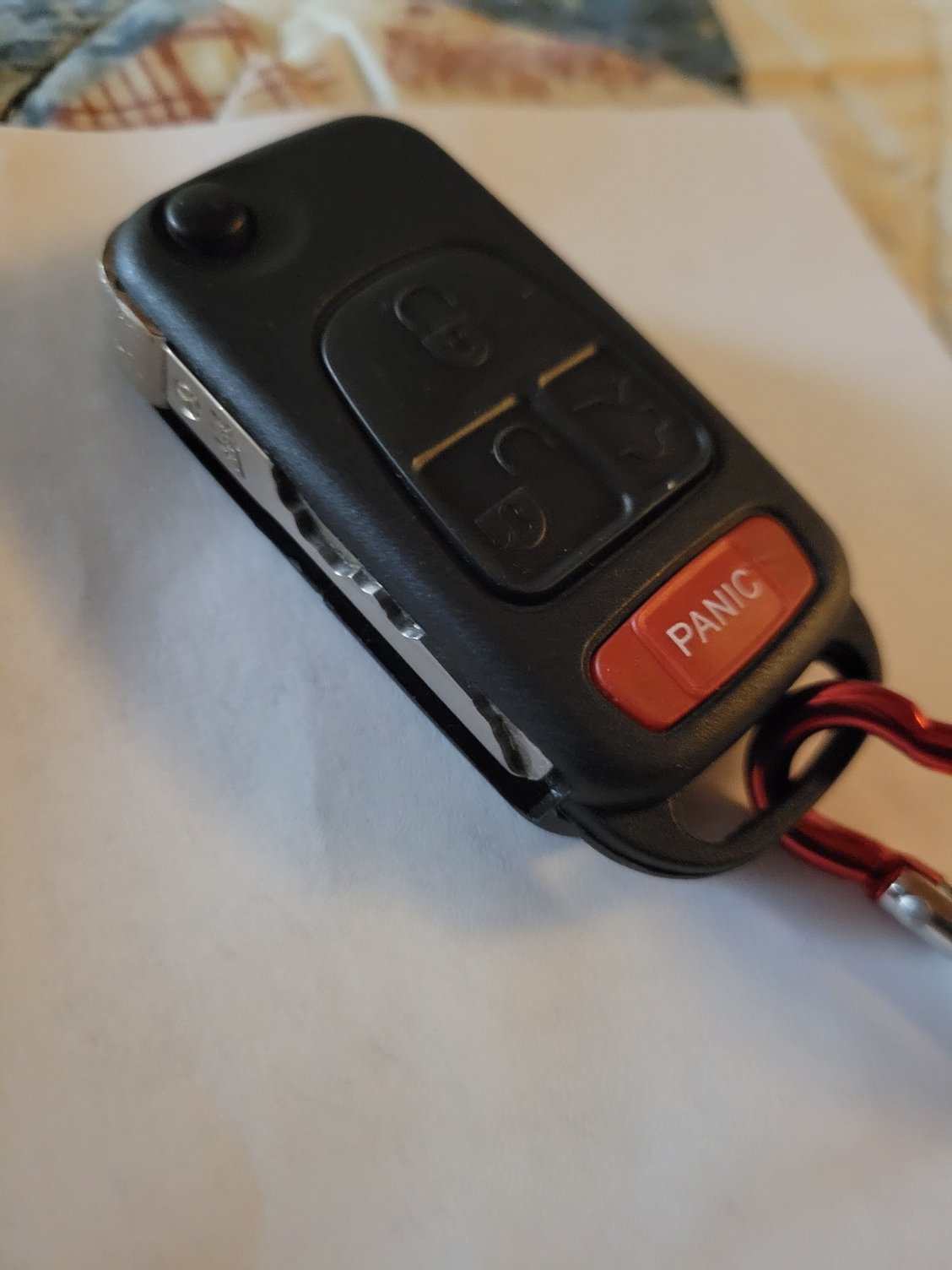

The remotes for the ML 320 I just acquired were 24 years olld. The outside of the FOBs were in less than perfect condition. I found new fob shells on ebay, chnged the electronics and keys from the originals. Also found a 4mm mecerdes sticker / round stamped alu. black with the MB star in sliver amd 3M stickey on the back. I placed them on the back sides of the fobs. I changed both battries and re synced the fobs to the 320. they arent the better quality as the original but for 31
usd I have a functional pair of fobs that look original and function as new.
