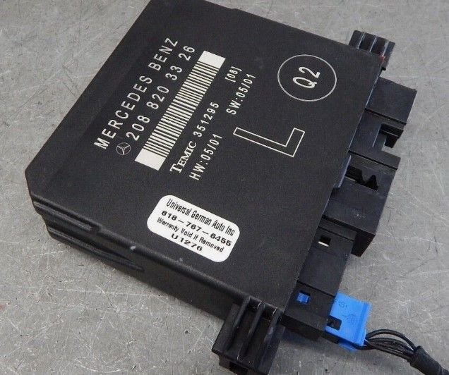

For example, for my 2000 CLK it came without autodrop windows. 208-820-13-26 door module factory installed. Very hard to close the doors due to air pressure because the HVAC function to open to vent t0 outside air when door was open did not work. In 05/2001 a new door module with autodrop was introduced. 208-820-33-26. I bought a used -33 (left side, for example), installed it and presto - auto drop. No more broken door handles.

-n3 is for left Door, as also shown by
-n3 is for left side, as also shown by "L" -3n is the parts modification sequence
