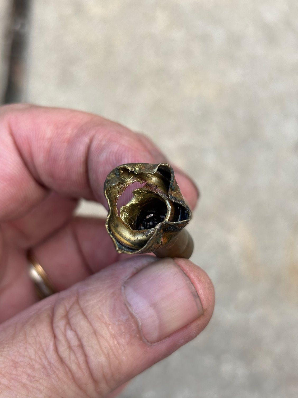

Oh Boy.  Yes I just had this happen, and it’s difficult to get it out.  Basically, I used some dental pics to essentially remove all the remaining plastic.  What is then left is essentially the Outer Shell.  In my case, it was for lack of a better word, fused to the block.  Again I used the dental pics to carefully pry the edge around the casing and the block.  This more or less mushrooms the casing enough to allow gentle pulls with needle nose pliers alternating from side to side, top bottom et

Hey Casman,
Thank you for the reply. If you don't mind.... were you prying against the bore with your picks ? I'm paranoid about scratches. If I'm not mistaken, the o ring / seal gets compressed when the clip is installed, so the bore may not be that critical. Obviously, I haven't seen the layout inside since mine is still in there... Did your sensor seal correctly...? In retrospect, do you see any other alternative means of extraction ? I'm also too paranoid to use an ez out, for the same reason.

The pic would go straight in, then I’d pull it upward. Of course you’d want to be cautious, but once in, the upward pull isn’t a concern. Do not use or try an EZ out. I lightly sanded the bore after I got the old one out. There are reported issues with installing some aftermarket replacements specifically related to the size of the O-Ring. Just make sure you get it all the way in before pushing the retaining clip in. If you think it’s in, and when looking straight down you see any part of the outer casing, it’s likely not all the way in. Obviously if it leaks afterwards you’ll know. Good luck.

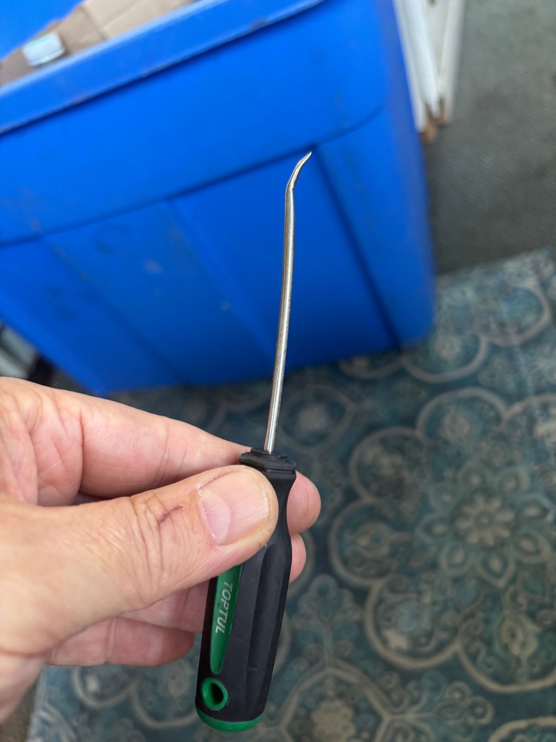

Once I got some separation, this tool worked very well.

Thanks again Casman.I didn't see your post with the tool. I have some lightweight O ring picks. Hopefully they wont bend too much. I was thinking about modifying a punch or drift to be a little stouter...As you can see I'm trying to sneak up on it.....

You’re getting it. Next what I did was grab it with some needle nose pliers, and pull on it. Alternating side to side, top and bottom, anywhere you can get a grip. It’s only fused around the bore. After awhile, it will jar loose. You got this.
