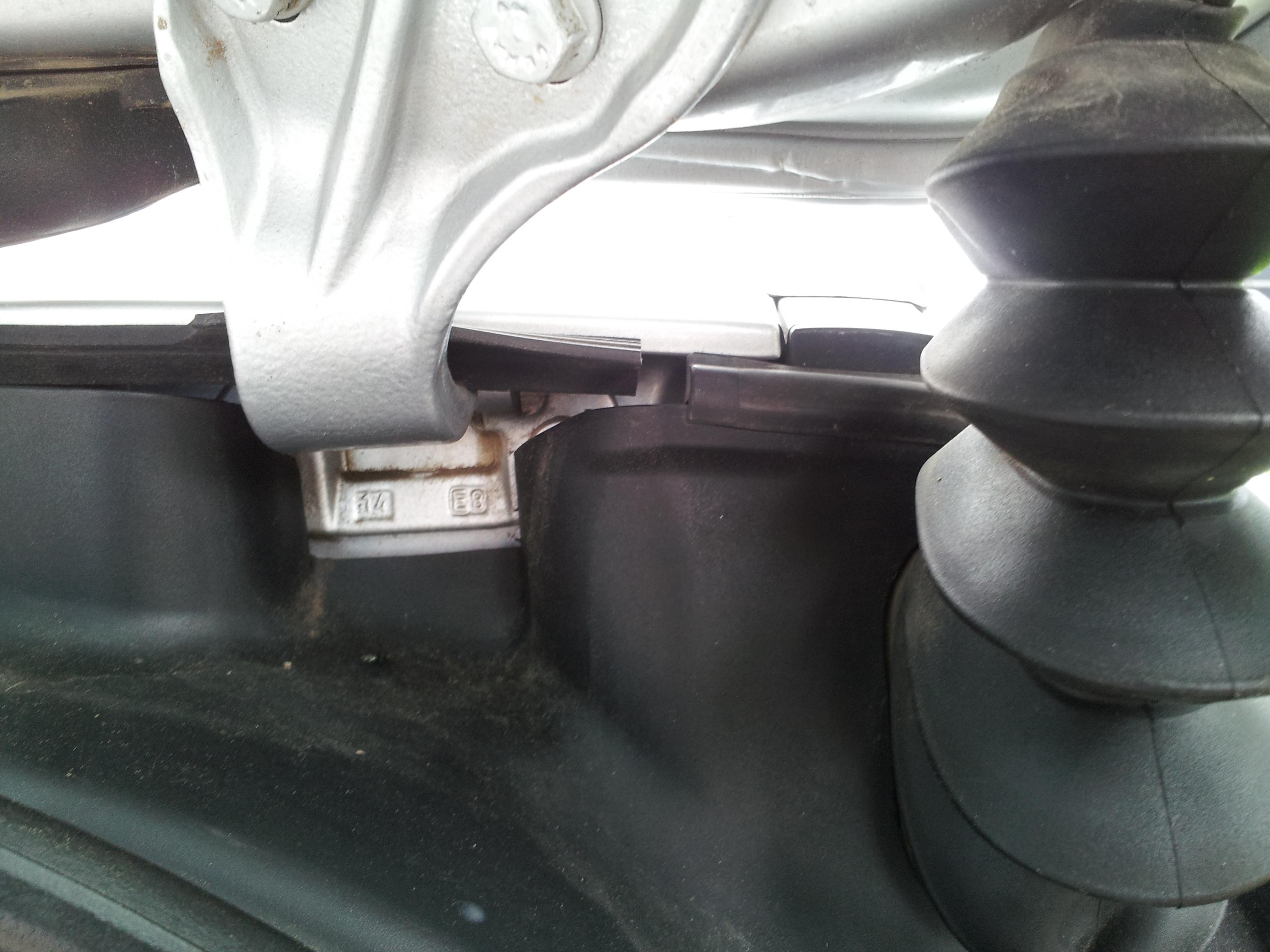

Is this gap, at the top of hatch seal, normal?
And, if not, will water that gets through that gap end up inside the fender (like dripping onto the SAM)?

Just stopped by my local independent expert. He says that the gap is normal and that the updated plugs on the back are correct. His thought is that the leak must be behind the tail light, and he also mentioned that he has had good luck with putting a cover over the SAM.
The dealer mentioned another issue with leaks from the roof rack, if its screws loosen up. I don't notice any play in the roof rack, so I don't think that's an issue for my car.
I'm going to add some sort of cover and pull the tail light to see what I can do to improve its sealing.
