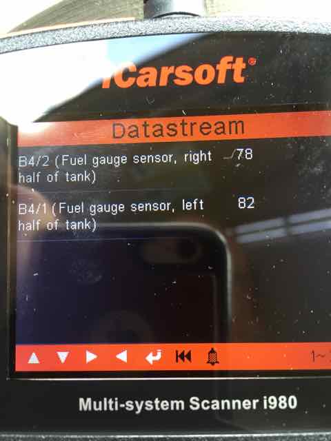

Some progress, I replaced the rear SAM now most things are working but no Fuel gauge or Passenger seat motion.
My icarsoft code reader does not throw up any codes re the fuel sensors ( There is a left and right) can anybody throw any light on these values ?

So it appears that although MB dealer says no coding is necessary. that is not always the case, My passenger seat is not memory and the SAM comes coded for Memory Passenger seat so once that was coded we were good with that. the fuel gauge took a little more with a software /Firmware flash and now that works fine.
I am posting this solution to help anyone else in this situation
