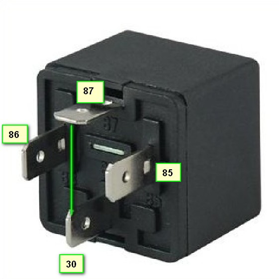

Don't assume that it is the starter. Remove the starter relay, check to make sure that it is the relay by reading the chart on the cover, and does it look exactly like the photo below?
