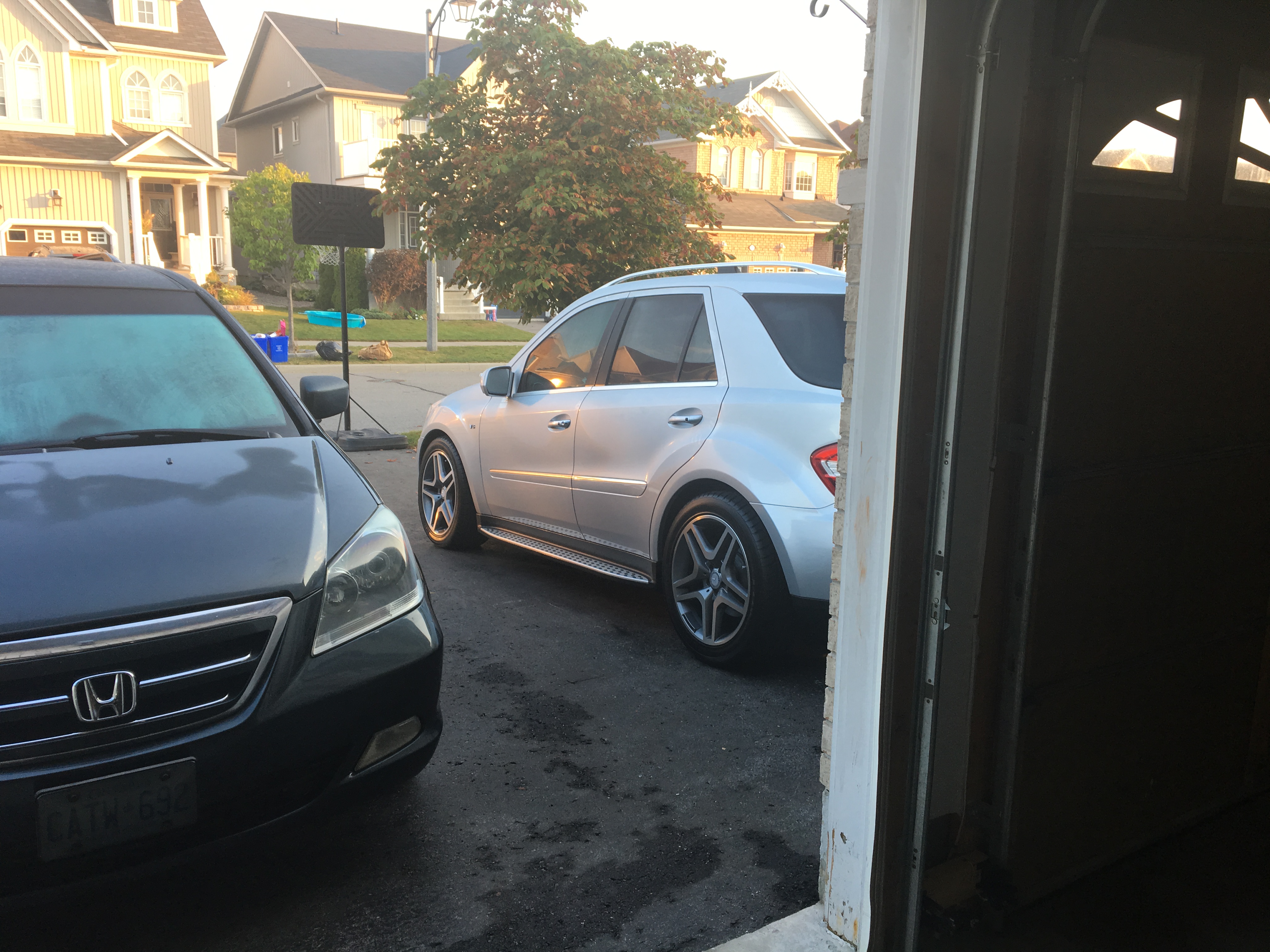

Old Sep 27, 2017 | 10:35 AM
OUZO Power's Avatar
Joined: Mar 2015
Posts: 347
Likes: 47
From: Brooklin, Ontario
JGC SRT, ML 550, GLB 250
Rims: 20 x 9.5 with 46mm Offset
Tires: 275/45R20
15mm spacers on the rear.
Attached Thumbnails 20x10 all around-img_1435.jpg   20x10 all around-ml550-eurocharged-2.bmp

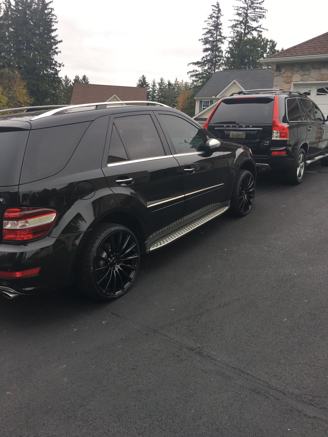

Originally Posted by Rjosep01
wow 295/40/20 that sounds so much wider... is it??? I would assume if you go down a ratio in sidewall you can go up in width??? You aren't having any issues turning or rubbing? Would you mind showing me a pic of your setup? I actually love the idea of an aggressive stance. Just haven't got a clue what to do... everything I bought can be returned so I haven't fully committed to a look yet. So thanks guys for the input!
There are no turning or rubbing issues on my non-airmatic setup, even after lowering the vehicle.
I was advised by the Vossen team and the authorized dealer I went to for the install that 295/40/R20 is the setup I need to fit 20x10 tires comfortably on an SUV.
My winter tire setup is the original 255/55/R18 OEM wheel, otherwise, you're skiing on the snow and not driving on the road.
See below a chart of the two sizes.
The two specs are super close. I wanted as little speedometer variance as possible
After lowering the car, I aligned it to run a -1.5 camber in the front and -2.0 in the rear, which tucks the top end of the tire to the fender line perfectly.
If you have original spec alignment numbers you may see it stick out of the top fender about 3mm running the 295.
I'll see if I can find some pics showing the stance in one of my albums when it sits on the ground. I only found an install pic for now.

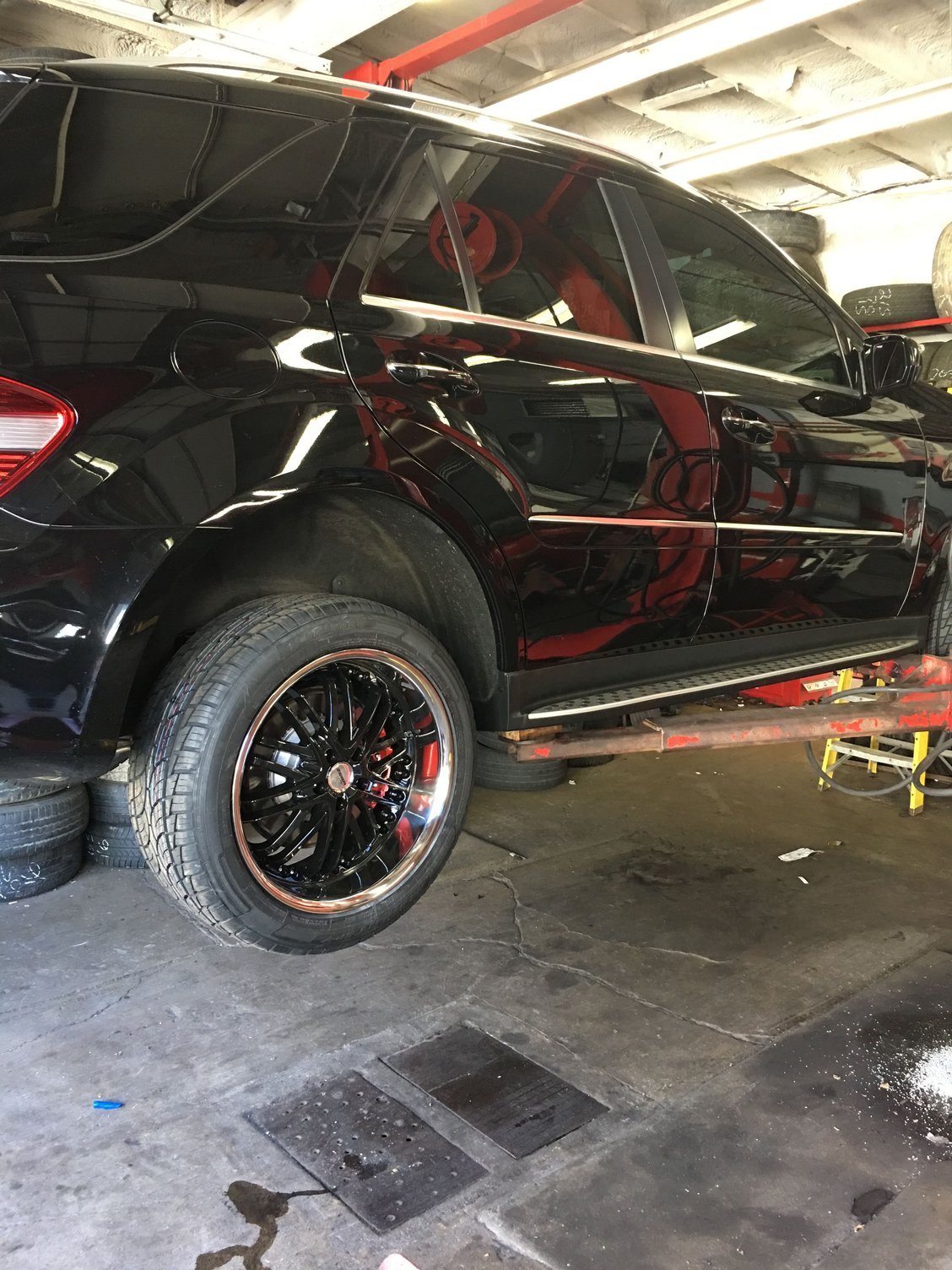

So I got the 275/45/20 tires and went to put everything on the vehicle but they said the lug nuts were a tad too long. Had to get spacers. They won’t have them until tomorrow. Caught a glimpse and it doesn’t look bad at all. Hard to tell what the wheel gap might be because I only saw it elevated.
I asked to get an alignment but now you guys are talking about lowering options??? I understand it may be a personal choice but help me out guys... does lowering the ML help in looks, performance or both? And what’s the anticipated cost to do it?

Lets see some pics.
Old Oct 16, 2017 | 01:18 PM
Rjosep01's Avatar
Joined: May 2012
Posts: 14
Clk 350
Originally Posted by OUZO Power
Lets see some pics.
Ok here she is...
Old Oct 16, 2017 | 02:32 PM
OUZO Power's Avatar
Joined: Mar 2015
Posts: 347
Likes: 47
Looks great. But man do those tires look under sized. Also gotta drop that sucker.
