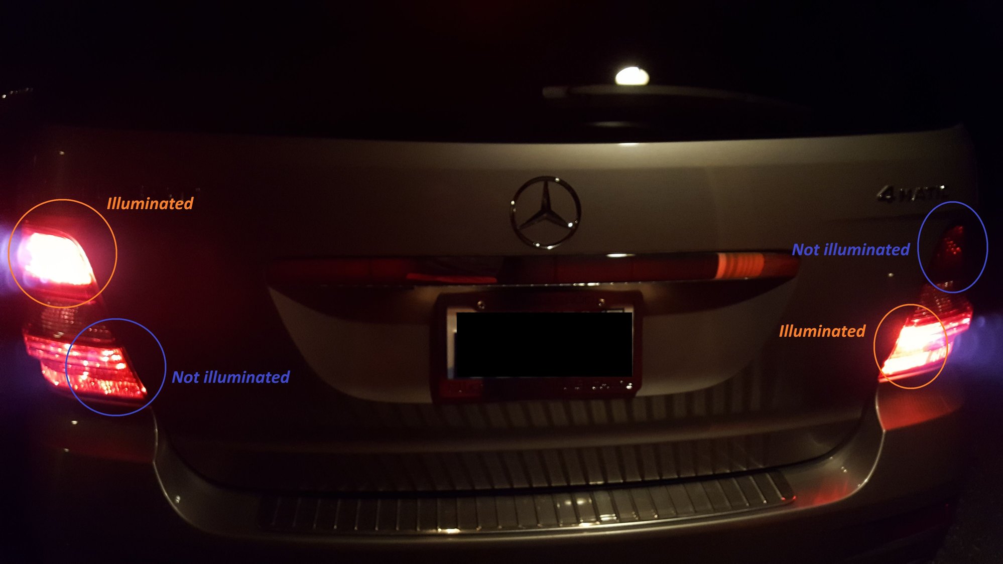

I'll try that out. If it doesn't work, I'll just have the MB dealership replace the harnesses. I think the front side marker doing this was a weird one-time thing, as I haven't had it since I first saw it. Here's a picture of what we've been dealing with lately, but sometimes the order of bulbs not working is reversed, etc...

I just finished sanding the bulb socket contacts and the part of the frame where they go (admittedly not that good, as I didn't remove the tail light assembly, I just did it from the right rear quarter panel) and I'm still getting the same results. However, it looks like the lower tail light bulb that illuminates on the right side when the brakes are pressed isn't supposed to illuminate on the left side when the brakes are pressed, but rather when the rear fog lamp is turned on. So, in this case, the message on the dashboard that we've been getting (Rear Right Tail Lamp Out) makes more sense, as the only bulb that's not illuminating when it's supposed to is the upper right brake light bulb. So, I replaced that light bulb. Didn't work. I swapped the left brake light bulb socket and bulb with the one on the right. The left brake light still works and the right one doesn't. This makes me think there's something wrong with either a harness or the contact on the frame, because as I said earlier, I didn't sand it very well. Here's a video of the issue. First, I turn the parking lights on. Then, I turn the parking lights off and turn the car on. I test the brake lights a few times. I turn the parking lights back on and test the brake lights with those on. Then I turn on the rear fog lamp while the parking lights are still on and test the brake lights.
https://drive.google.com/file/d/0Byv...ew?usp=sharing
What should I do to remedy this? I should add, I'm looking to replace the current assemblies with Anzo LED assemblies in the future, so keep that in mind when giving me suggestions on what to do. Thanks in advance...
