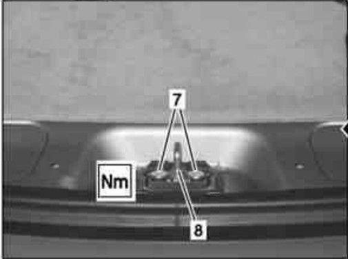

When closing the tailgate, does it only make the noise when it meets the locking eye?
Good morning
No, it make the noise the moment the tailgate start moving.
Both when opening and closing so its the system that move the tailgate, not the lock.
