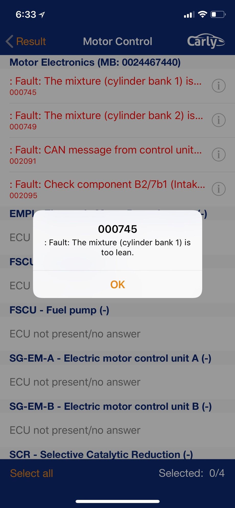

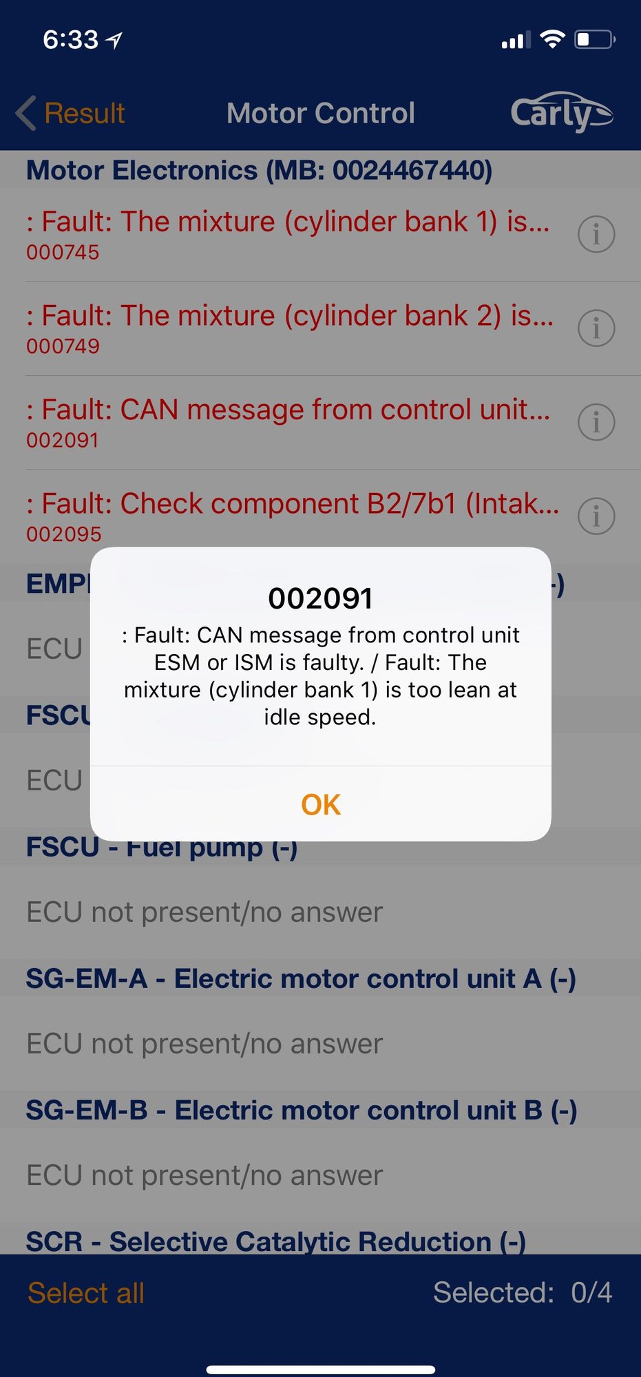

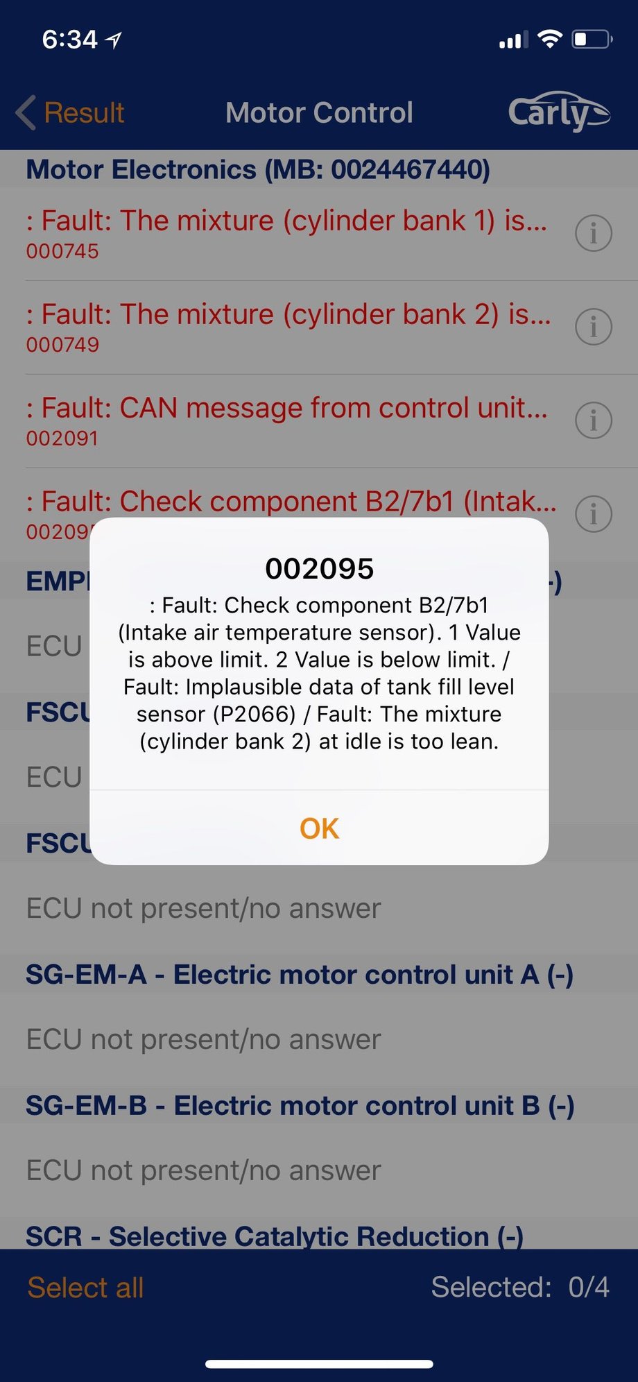

the MyCarly app gave a lot more detailed info than other scanners, but codes do not appear correct either.
Should I remove everything from the throttle body and put it back on to see if that clears anything up?
Anything else I should check? Thoughts are appreciated.
