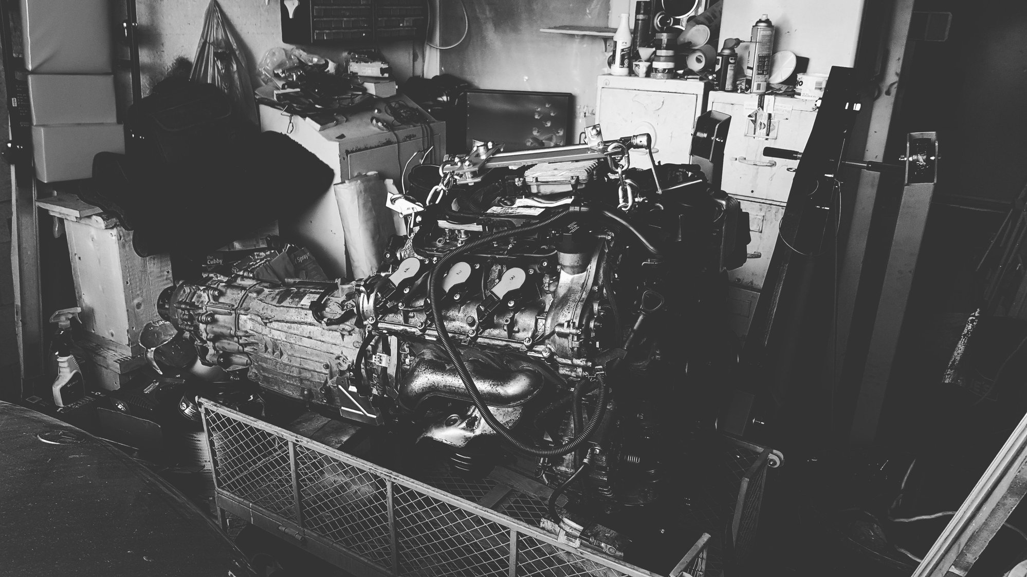

Do the camshaft sensor check and see what comes up. If the sensors are alright then maybe switch out the camshaft timing sensors, of which there are four per side. Not a major job.
I just finished buttoning up the engine and transmission after replacing the balance shaft and tomorrow I'm going to place the engine and transmission back into the car.
If you plan on doing the job yourself there is a .rar file in the forums which has all the documents you'll need and I'll be more than happy to help you along the way with any other supporting documents.
