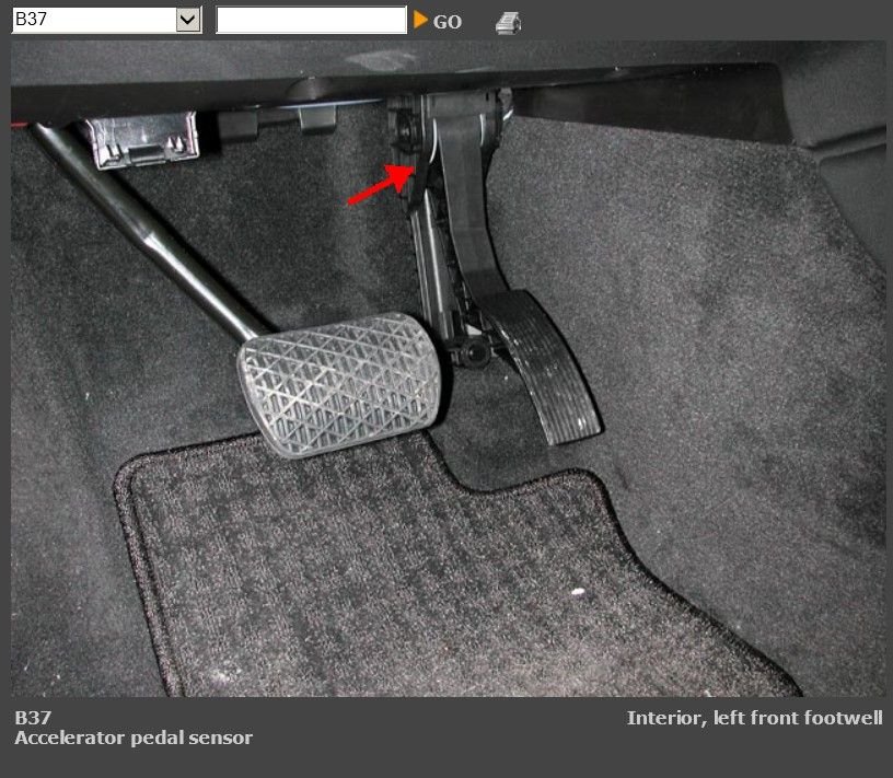

Yes the faulty pedal sensor could be causing the trans. problem. Why don't you replace it since the code returns? There are 4 possibilities for the sensor, broken wire on the connector, plausibility or voltage problem.
Call your dealer with your vin# and tell him you need an Accelerator Pedal Sensor.

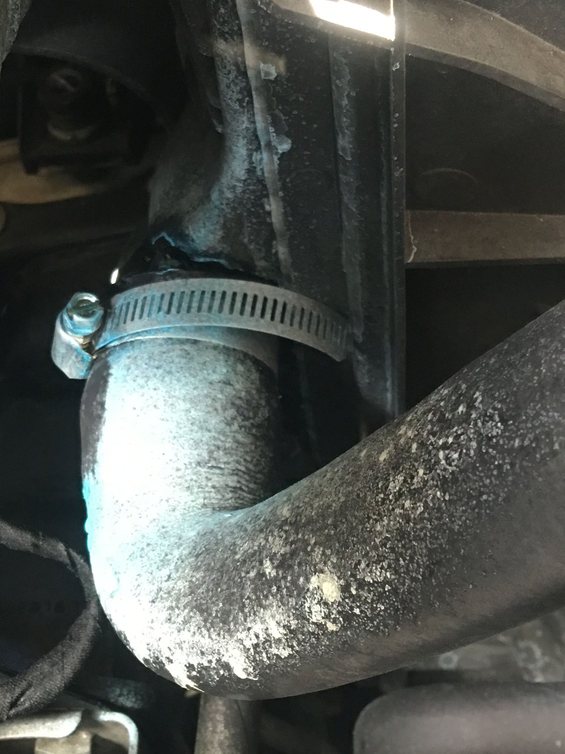

The leak on your hose could be the radiator itself leaking.

Thank you maj,ill go ahead and do that now. As well as got get a new hose. I took the liberty to go take pics so you can see what i was talking about.👇🏾👇🏾👇🏾 This is where the leak is coming from

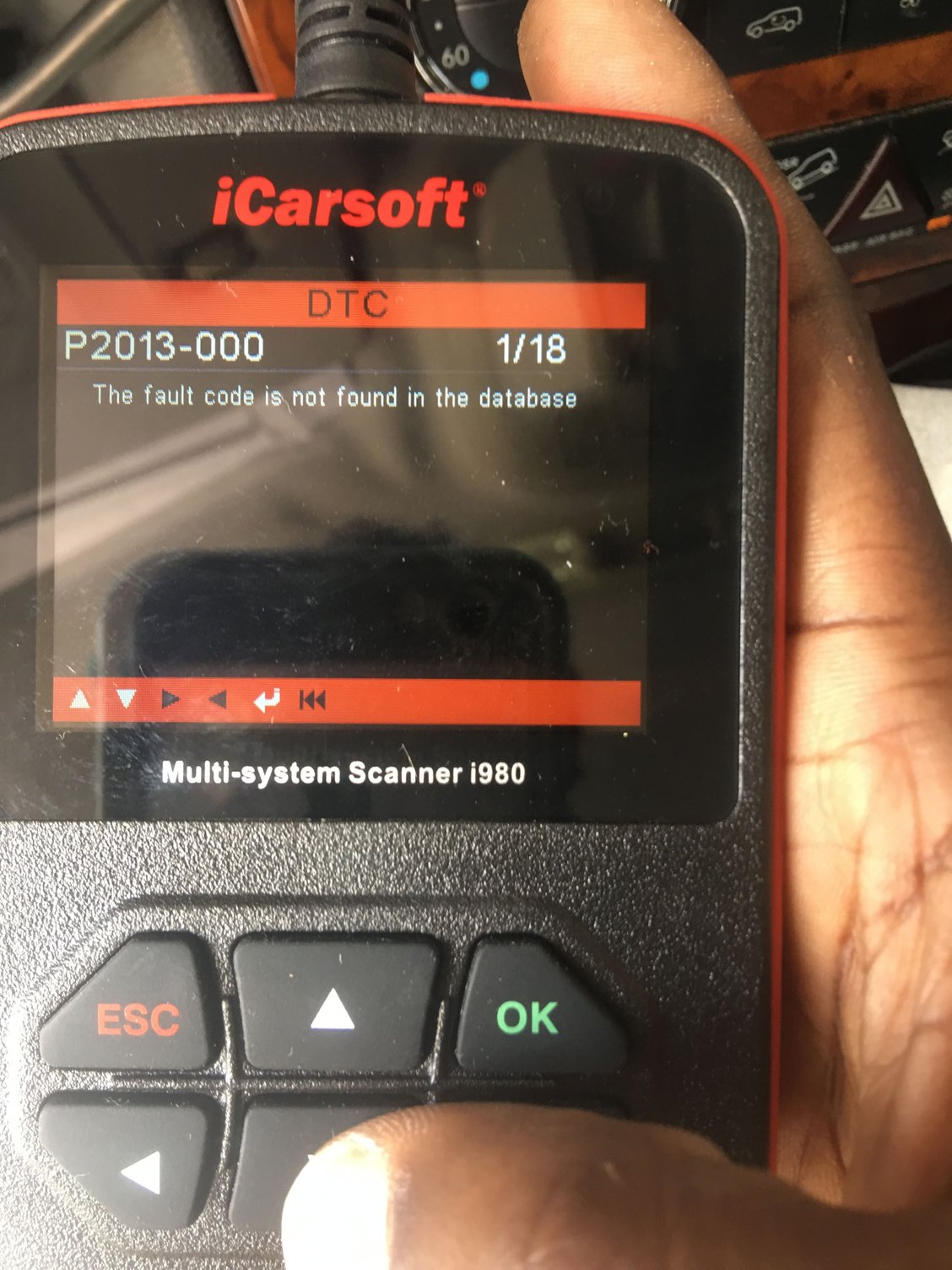

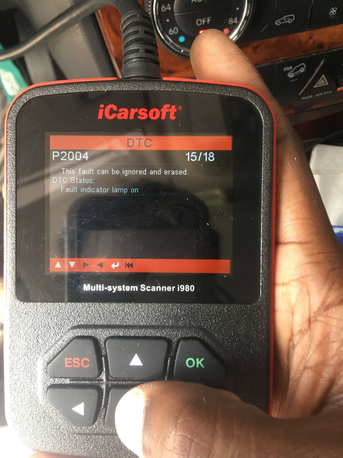

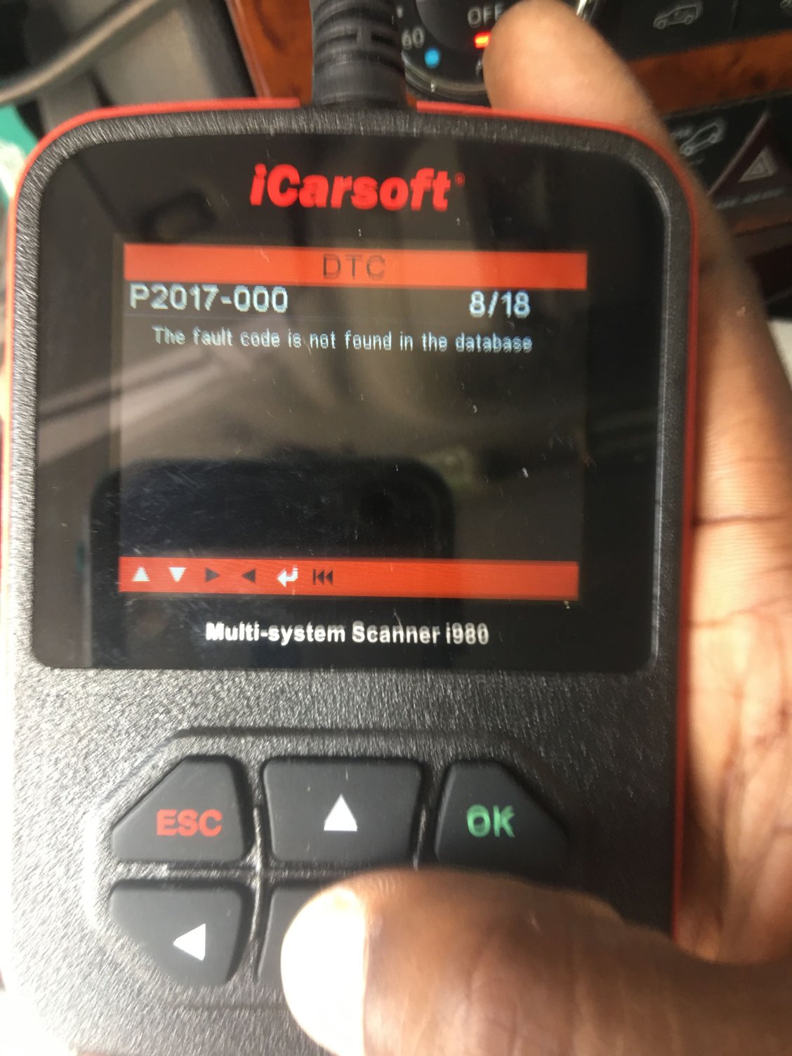

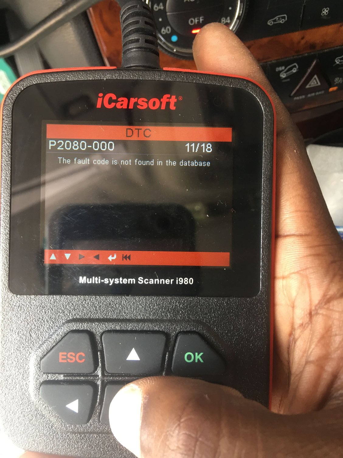

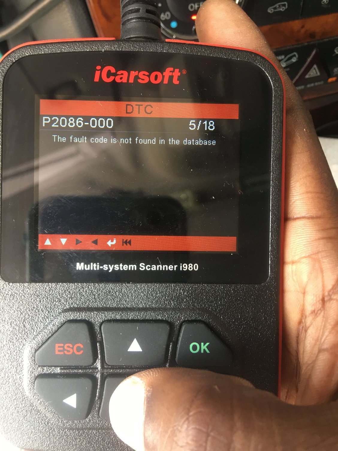

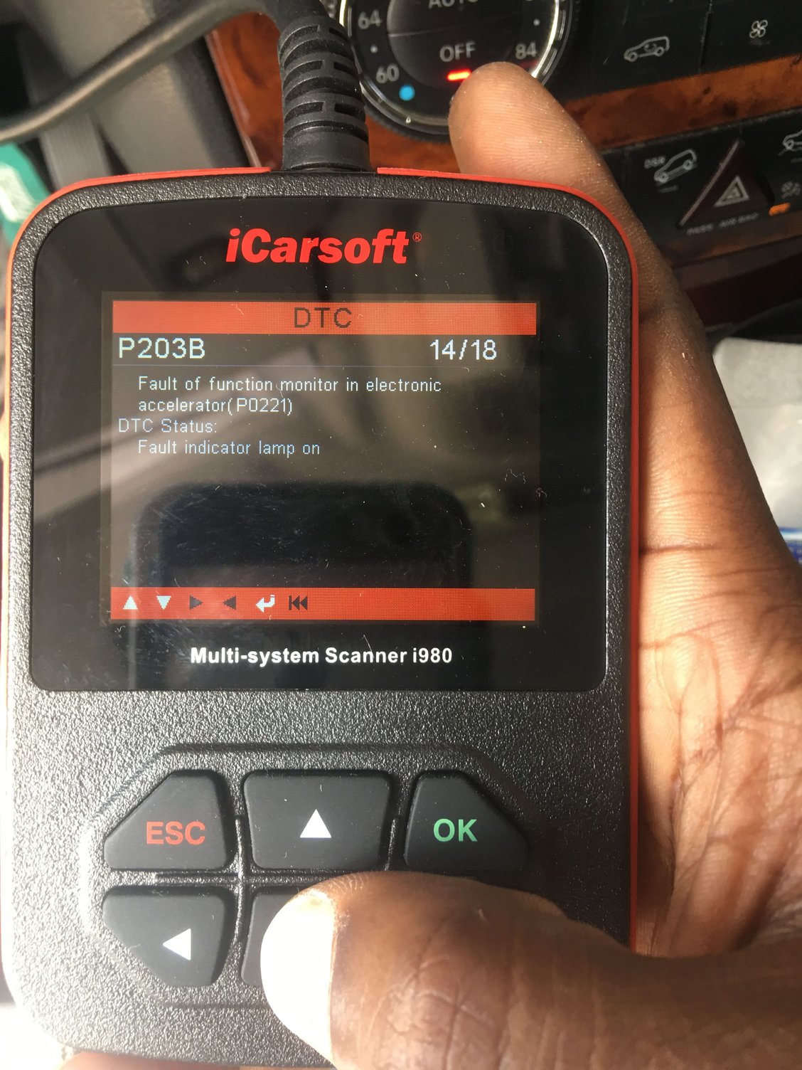

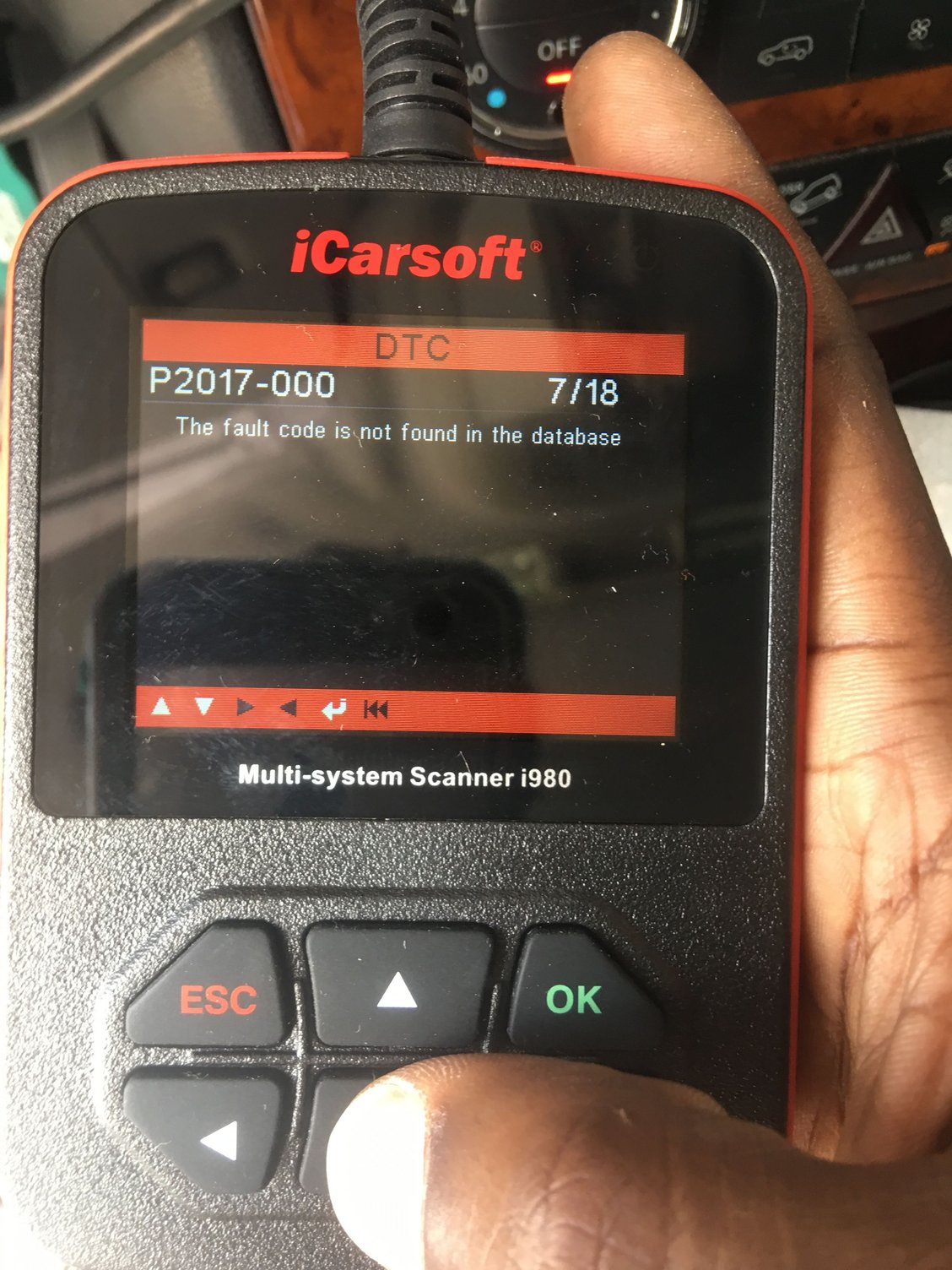

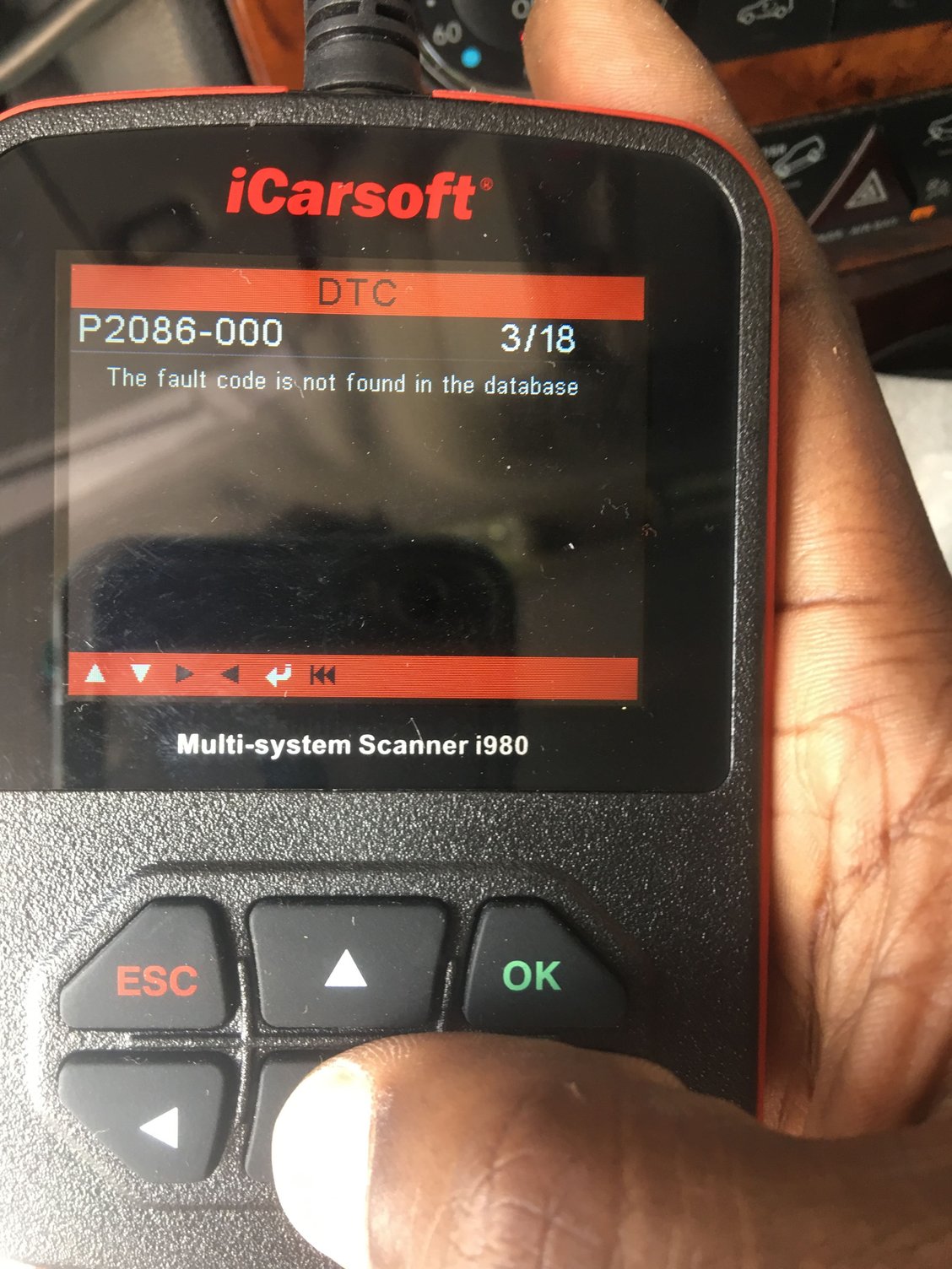

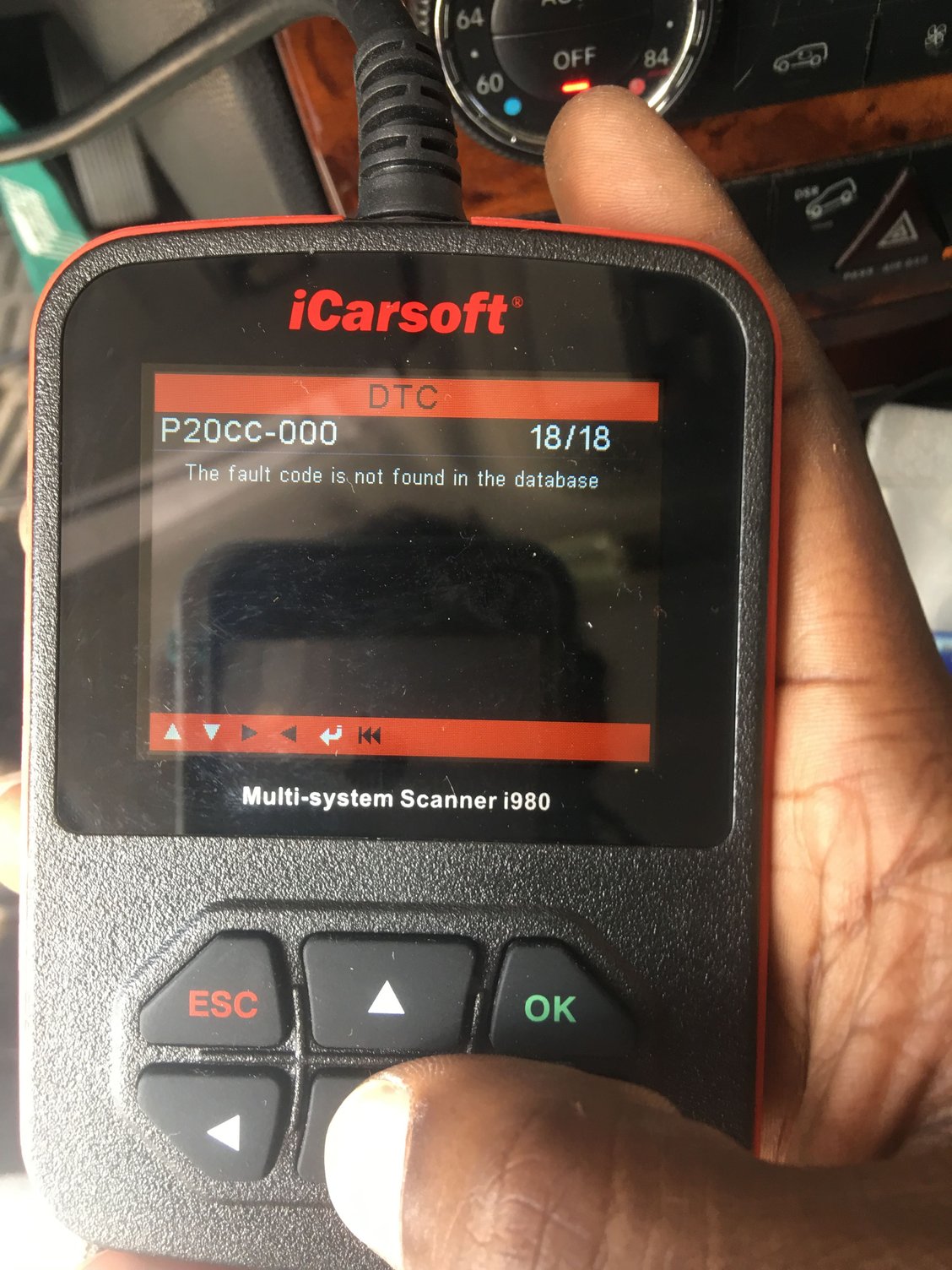

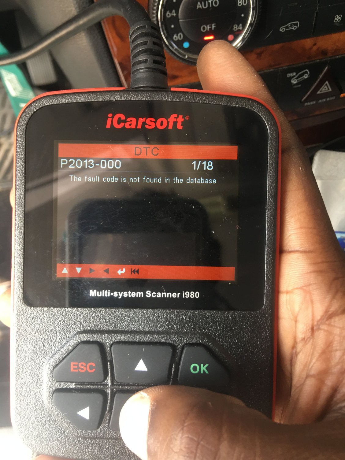

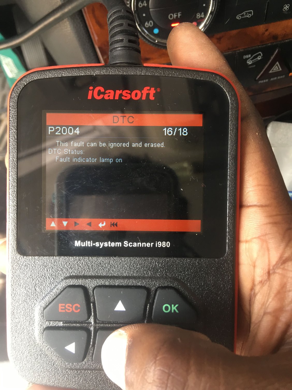

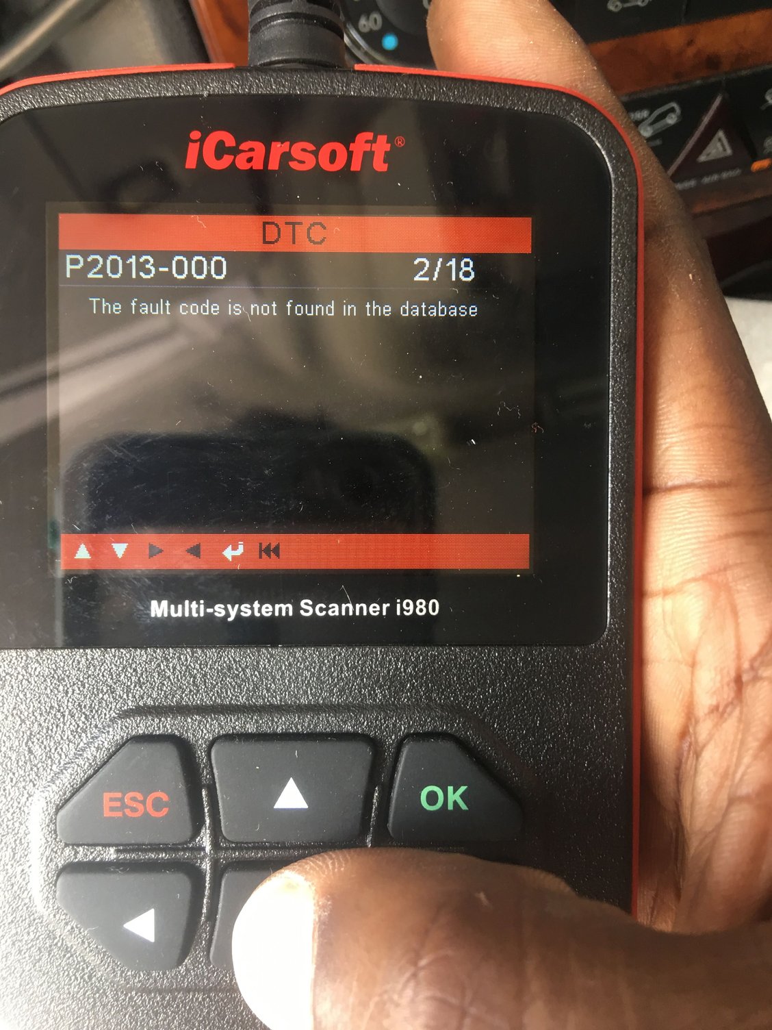

Also i took the liberty to take a pic of the fault codes
These are the codes that were detected. Once i cleared the fault codes,cut the car off and turn it on again and ran the test. It said no DTC

iCarsoft is not going to do the trick unless it can read codes in Trans. Module and the ESP Module. They don't even give explanations for each code.
Scroll through the 9 pages looking for yellow highlighted sections for the explanations of your codes.
I suggest you clear all the codes. Drive the truck as usual and carry your code reader. As soon as any light comes on the dash, pull over and immediately read the codes.
